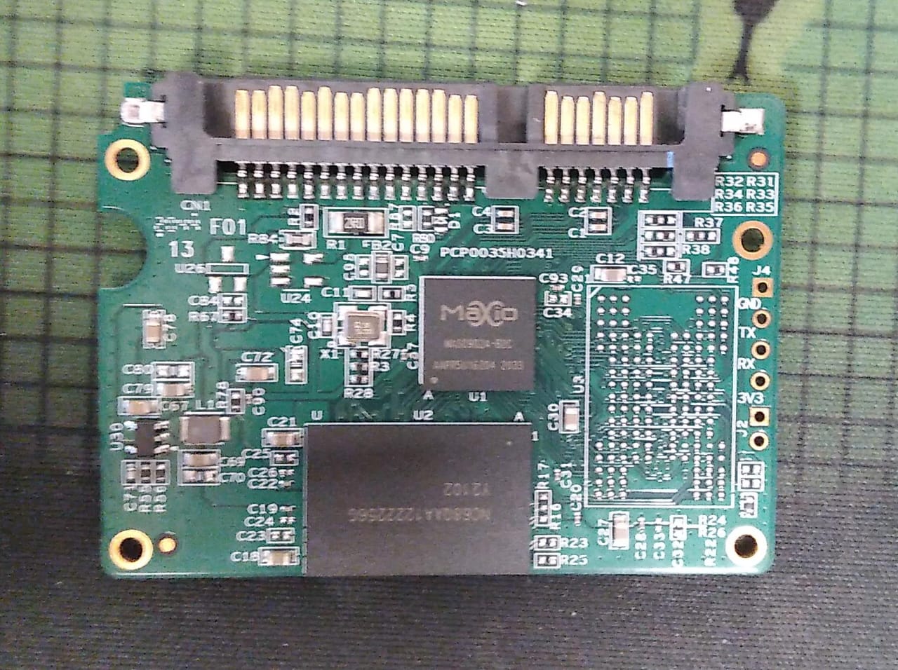

I have the following SSD:
Model: APS-SL3N-240
Manufacturer: PIONEER
Capacity: 240 G
Cover Label: PIONEER
Controller Label: Maxio MAS0902A-B2C

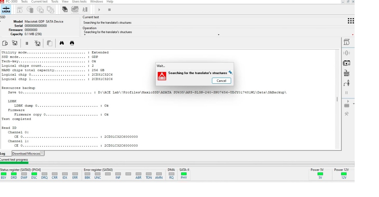

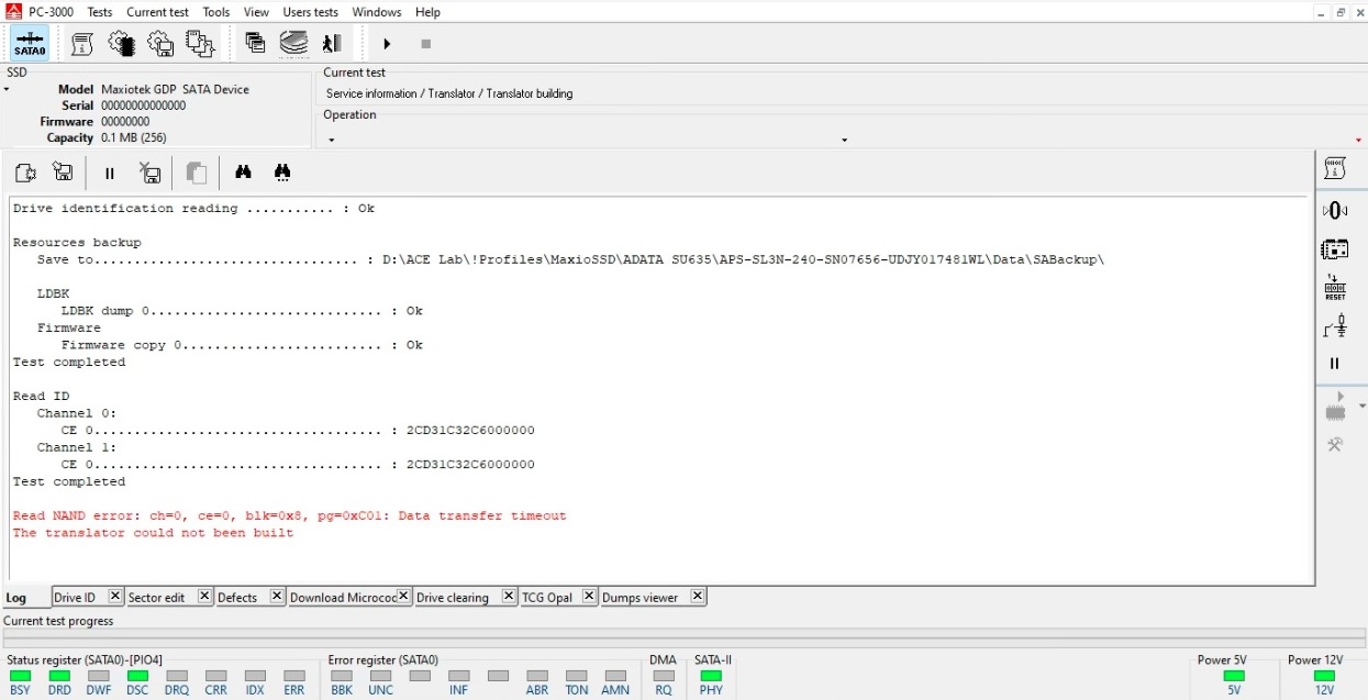

Every thing is fine , but when I try to build translator, the utility freezes as shown in the attached picture,
I tried SU635 model,
can any one help
thank you

Re: Maxio MAS0902A-B2C translator
Postby Roman_TS » 15.01.24, 12:42
Hello!
At this moment, only ADATA SU635 / SU650 based on MAS1102A and MAS0902A are supported. Other brands are not.
ACELab developers are improving the Utility to make possible work with various types of MAXIO-Based controllers. We already saved a lot of different resources from a huge number of SSDs, so we are planning to research them and add a full MAXIO support in the nearest future.
