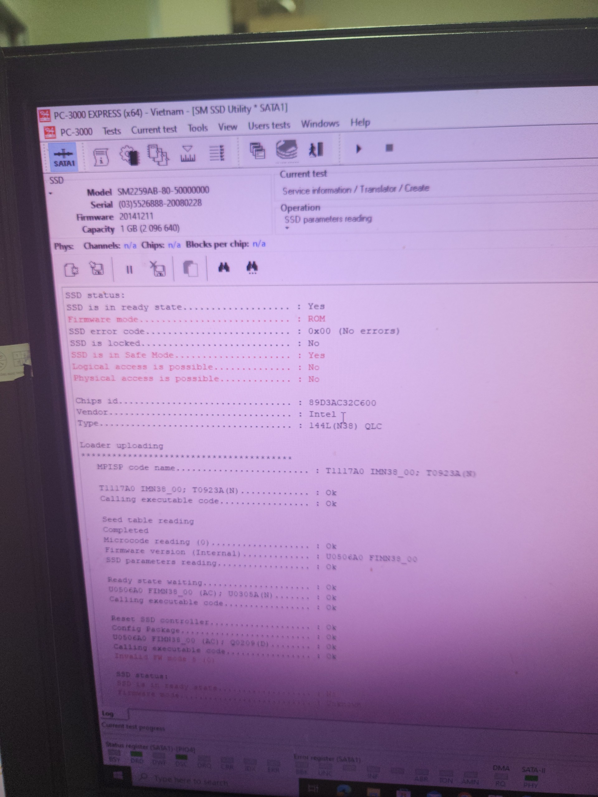

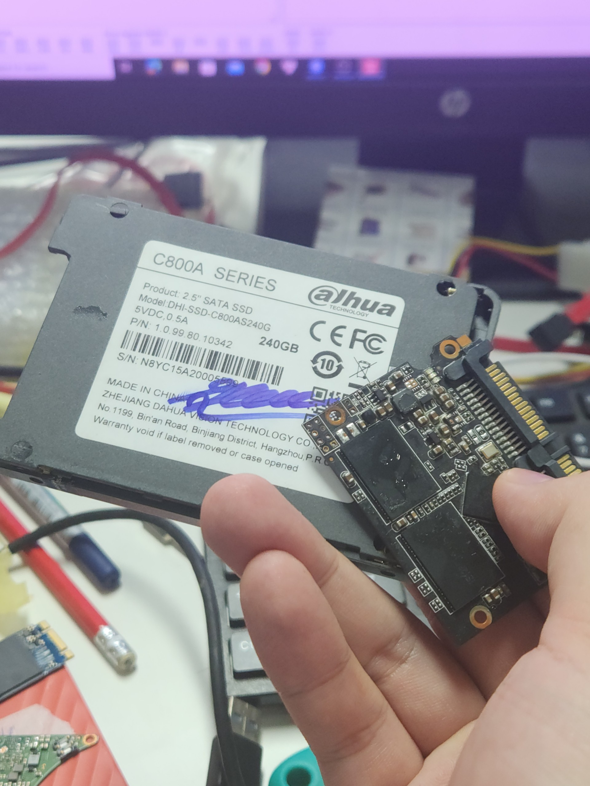

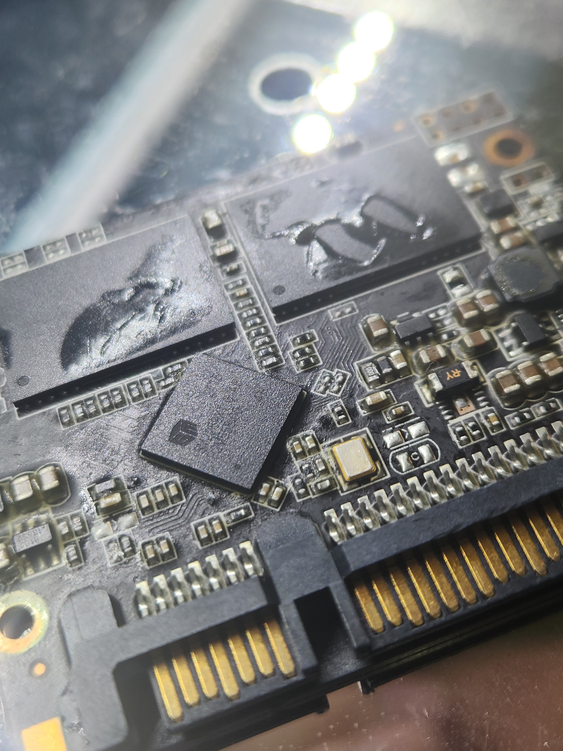

So i have this Dahua SSD
Uses SM2259XT Chip
Which has Intel chip with this type 144L (N38) QLC
I tried almost every loader and havent found the correct fw for it yet
Re: 144L (N38) QLC no correct loader
Postby Roman_TS » 22.11.23, 14:40
I think that if you already tried all possible loaders but didn't get any positive result, then you have just two options:
1. Wait for a new update, where the error processing for SM2259XT will be improved;
2. Cancel this case. QLC memory have a poor quality, and chances on a good recovery from memory where the charge been leaked - are too small.
