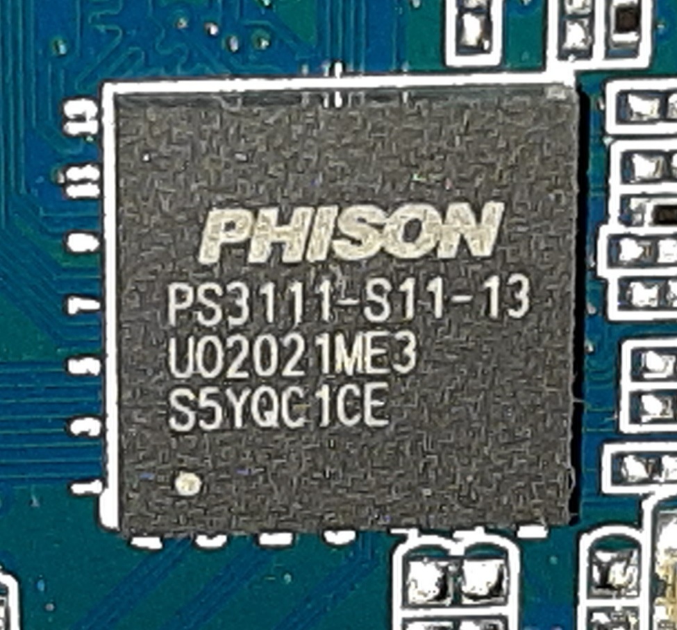

Real CPU name - Phison PS3111-S11 as shown at attachment.

You can use any Utility for PS3111. In your first post, you mentioned Controller HG2258 - a bit different model (different FW in compare with PS3111).
So, use SmartBuy vendor and select PS3111. Then load the loaoder and move forward with other steps.

Due to the log info, NAND chips are not reading. Probably something bad with CPU. Try to swap the NAND chips:
https://blog.acelab.eu.com/alternative- ... t-ssd.html
