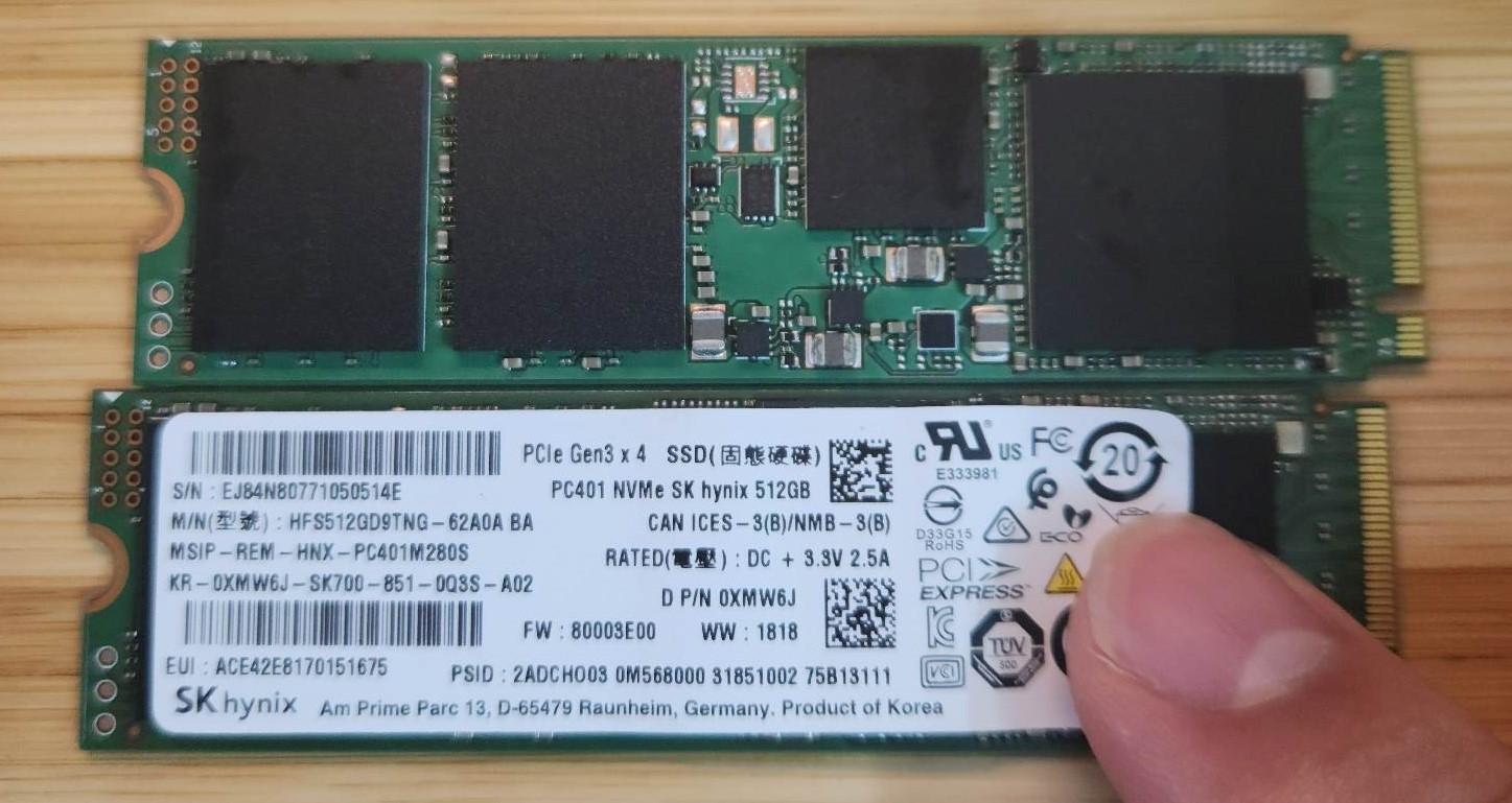

Uploaded a picture of the SSD

At this moment ACELab engineers reach a great success in 88SS1093 Marvell controller research. As the result of it, we were able to add the following models into support list:
1. Plextor N9e;
2. WD Black G1;
3. Sandisk A400 NVMe;
4. Lenovo NVMe;
5. Ramaxel NVMe;
The only drive which was not added but stays under development is SK/Hynix (SK Hynix PC401). Unfortunately, I can't say when it would be possible to work with this drive because all 88SS1093 drives have extremely complex internal structure. Maybe one day it would be possible, but at this moment we don't have compatible Utility for this model.
