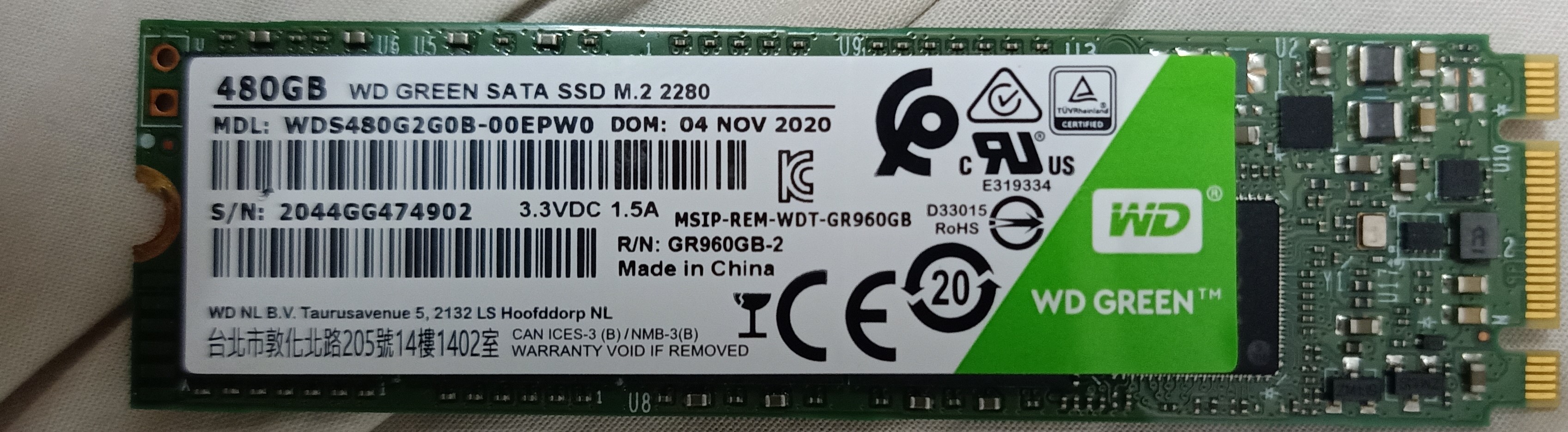

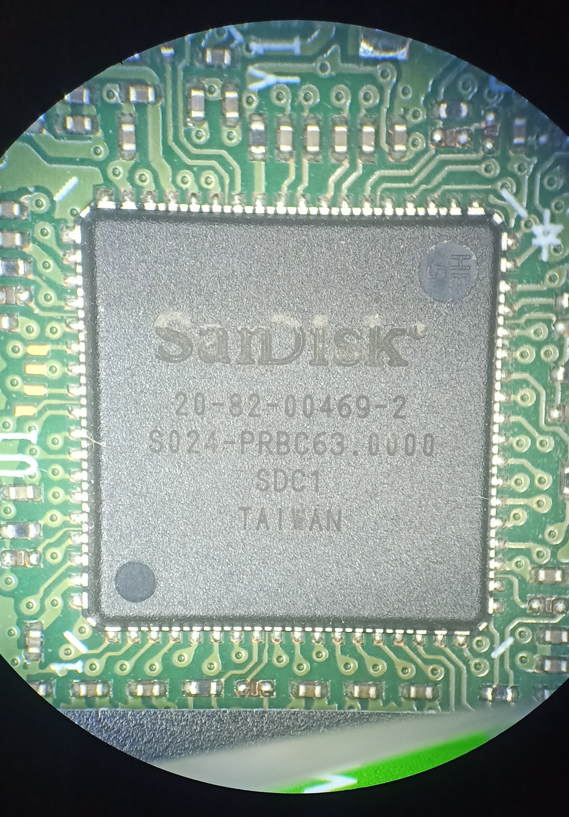

I Have a case with WD 480GB SSD Green M.2 Interface With Sandisk 20-82-00469-2 Controller .My Google Search Tells me this controller does not encrypt the Data in NAND and a chipoff should be supported in My Tools PC3K Flash and Others " .Does PC3K SSD Tool Support this SSD and Its Controller .I am attaching some images for everyone reference .
PS : I still have to check the behavior of this SSD ,Just received It yesterday .
WD 480GB M.2 SSD With Sandisk 20-82-00469-2 Controller
Re: WD 480GB M.2 SSD With Sandisk 20-82-00469-2 Controller
It's not supported by PC3k but can be recoved via chip-off.
- Amarbir[CDR-Labs]
- Advanced user
- Posts: 784
- Joined: 03.08.09
- Reputation: 8 / (80)
SGdata wrote:Source of the post It's not supported by PC3k but can be recoved via chip-off.
did you recover this kinda SSD with PC3K Flash or other tool you have ,You know what i am talking about
Just did last week. SATA version with FE.
- Amarbir[CDR-Labs]
- Advanced user
- Posts: 784
- Joined: 03.08.09
SGdata wrote:Source of the post Just did last week. SATA version with FE.
Well,
How Much Time did It Take
Few weeks as there were 4 chips that needed to be read many times with different RR to get the best result.
- Amarbir[CDR-Labs]
- Advanced user
- Posts: 784
- Joined: 03.08.09
SGdata wrote:Source of the post Few weeks as there were 4 chips that needed to be read many times with different RR to get the best result.
Well,
I will share my process with you ,were you able to make file system work in your case ,is 2 to 4 weeks ok time frame for this
Yes, file system works, most documents and photos work too.
- Amarbir[CDR-Labs]
- Advanced user
- Posts: 784
- Joined: 03.08.09
SGdata wrote:Source of the post Yes, file system works, most documents and photos work too.
Amazing ,
Thanks i will get this started soon after i get my payment .
