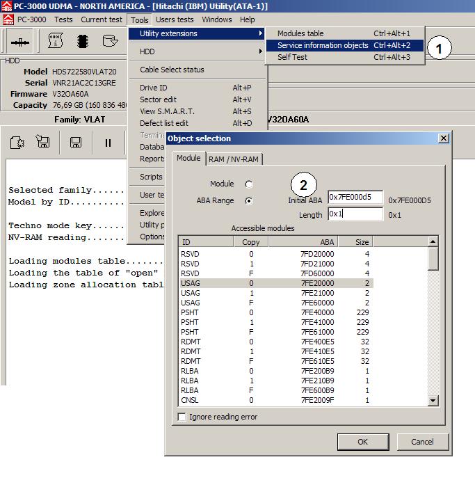

Sometimes it is happened, the board on hitachi-ibm drive dies completely with all its chips incluting ROM and NV-Ram chips. In this case it helps to find board with compartible ROM version and find NV-Ram on a surface.
Here are the settings to find it on HTS541040G9AT00
Use the "7FE000d5" address from my picture for all hts5410g9
Dont forget to turn off autoreassign before reading the data.
