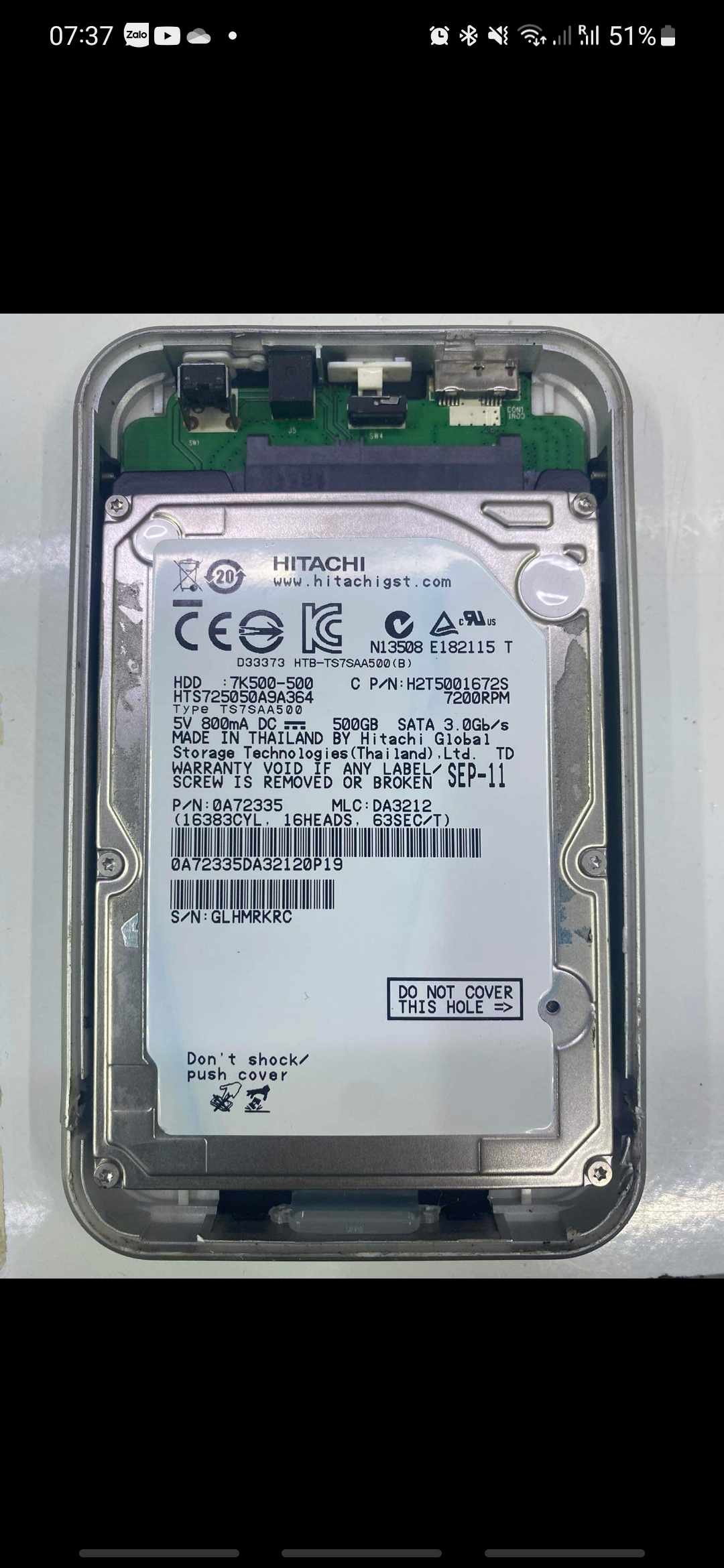

Postby gameboybin » 15.08.23, 06:39

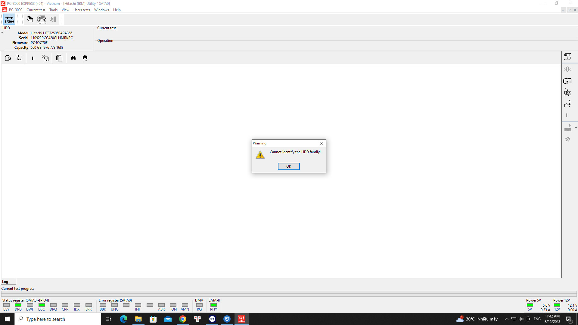

I know this is an elementary question. But please! Can someone help me which is the right Utility to open with this HDD???
Has unknown family upon identification
Re: Hitachi HTS725050A9A366 500GB Which UTILITY???
Postby digitalsupport » 15.08.23, 09:22
Hitachi-IBM> Custom > HTS7250A9
