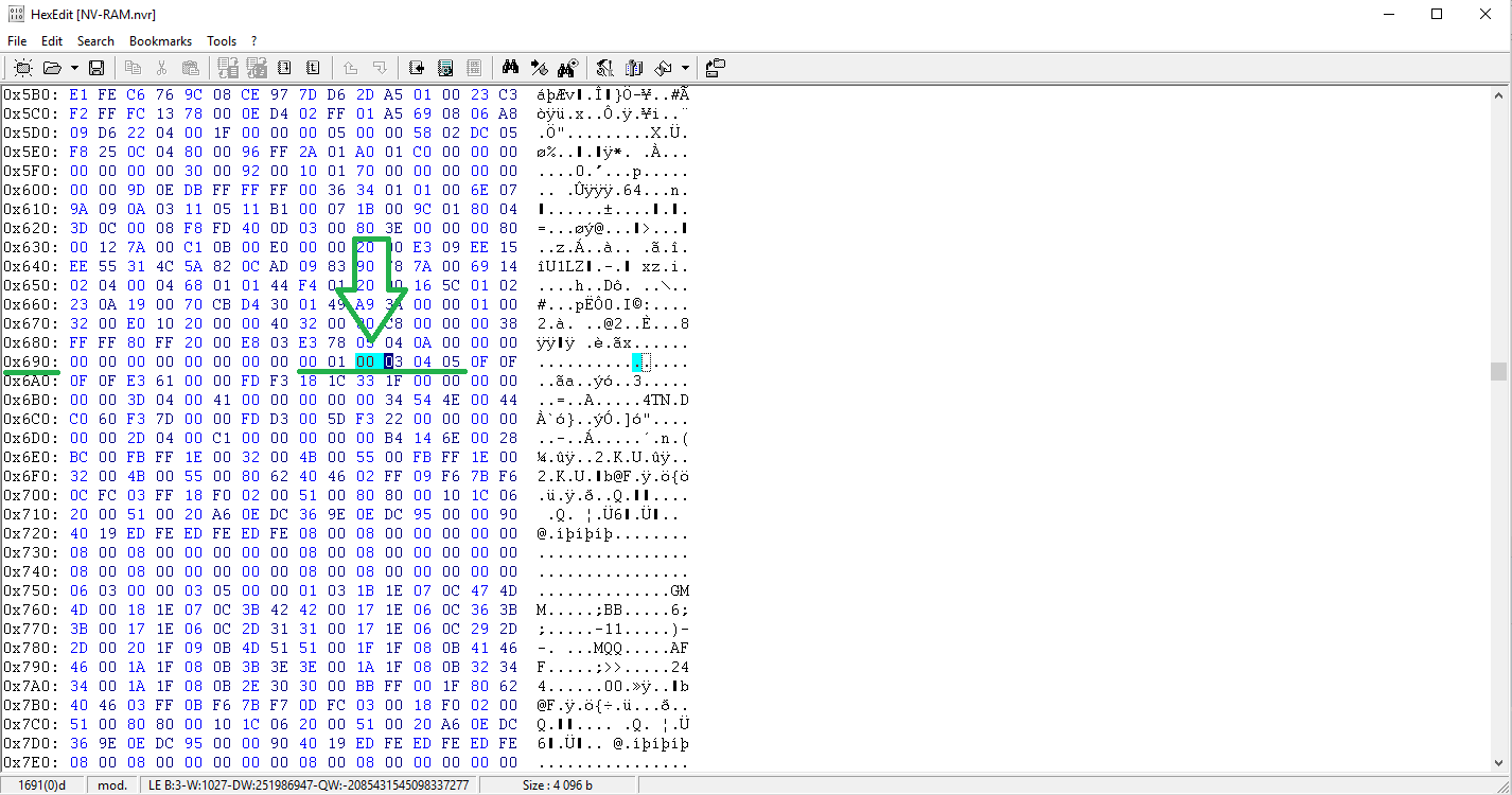

Head map is located inside NV-RAM (which is a part of ROM that you correctly mentioned) therefore you need to open NV-RAM (via Tools --> Service information objects), change requested bytes manually and save it.
Expand view Head map
Collapse view
Entirely ROM writing is not a good idea for this purpose :!:

I did like you said to disable hd2 in nv ram and now it looks like this when starting:
Selected family......................... : 5410A9
Model by ID............................. : <ID IS NOT READ>
Techno mode key......................... : Error
ROM reading...
Possible Tech Key is found. Checking...
Result.................................. : Ok
Loading modules table................................................. : Ok
Loading the table of "open" modules................................... : Ok
I was able to backup all resources.
Also i could read all surfaces except hd2. Still looking for donor to make complete recovery.

Joined: 28.12.16
Reputation: 1 / (13)
Re: HTS541515A9E630
Postby MasterT » 26.03.18, 15:39
Here you have it.
Nvram Edit.png (56.56 KiB) Viewed 31059 times
