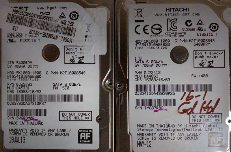

hi - I just did a head swap with hitachi tat I expected to work.
but the donor heads dont act like they can read the platters at all.
hitachi usually heads swap really easy.
What did I overlook?
I should have swapped the board before startiong just to test compatibility but i was so sure that it was going to work that I didnt bother.
If you swap boards isnt there a dnager that the nvram can be corrupted?
parient BMOP
Selected family......................... : 5410A9
Model by ID............................. : HGST HTS541010A9E680
ROM VER................................. :
NV-RAM ID............................... : 2000JA03B5E0
NV-RAM parameters
NV-RAM report
Loaded.................................. : Yes
ID...................................... : E2PR
mu-code................................. : 2000JA03B5E0
FW Ver (part 2)......................... : ³2
Heads................................... : 4
Head map................................ : 0 1 2 3 F F F F F F
donor = 7r8c
Model by ID............................. : Hitachi HTS541010A9E680
ROM VER................................. : 480
NV-RAM ID............................... : 2000JA0OB480
NV-RAM parameters
NV-RAM report
mu-code................................. : 2000JA0OB480

The donor drive for Headswap procedure should have are same:
1. Full Model Number. Example: HTS541040G9AT00, IC25N040ATMR04-0
2. Part Number. Example: 0F10311, 0A30243
3. MLC. Example: BA1116, DA2010
Your donor drive is not compatible

Perhaps you'd be wise to familiarize yourself with this page: http://www.donordrives.com/hard-drive-pcb-donor-match
It explains what needs to match, what should match, and what it doesn't hurt to match.
