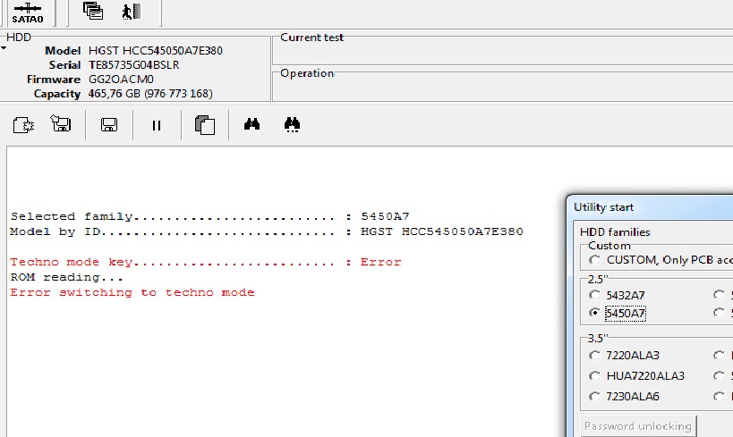

I need to unlock a hcc545050a7e380, but the family was not found,
Can someone help me? :mrgreen:

This is Hitachi ARM family.
Choose this utility in PC-3000 software

i have the same problem with a hcc545050a7e380 hitachi hard drive : is impossibile to unlock and also the tecnical support was unable to help me with a solution different to replace the nv-ram chip
home in someone's help
