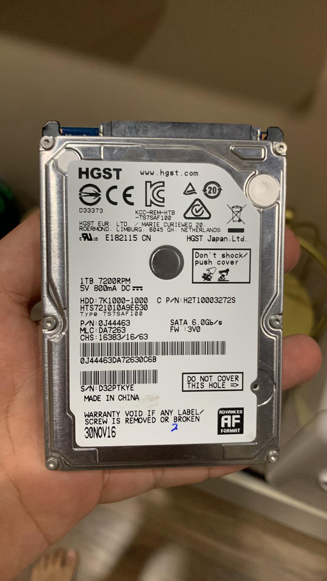

I have these 2 drives
1. HITACHI
HTS545025B9A300
250GB
2. HGST
HTS721010A9E630
1TB
They both were having clicking heads
I've changed the heads
Upon turning on they got Ready
And as soon as i click into any utility to ID the drives
I got the Abort message
What can be the cause of this problem???
And how can i fix this??
Does PC3000 have any articles about it??
Thanks!!

by MasterT
Bad head. Try editing NVRAM.
