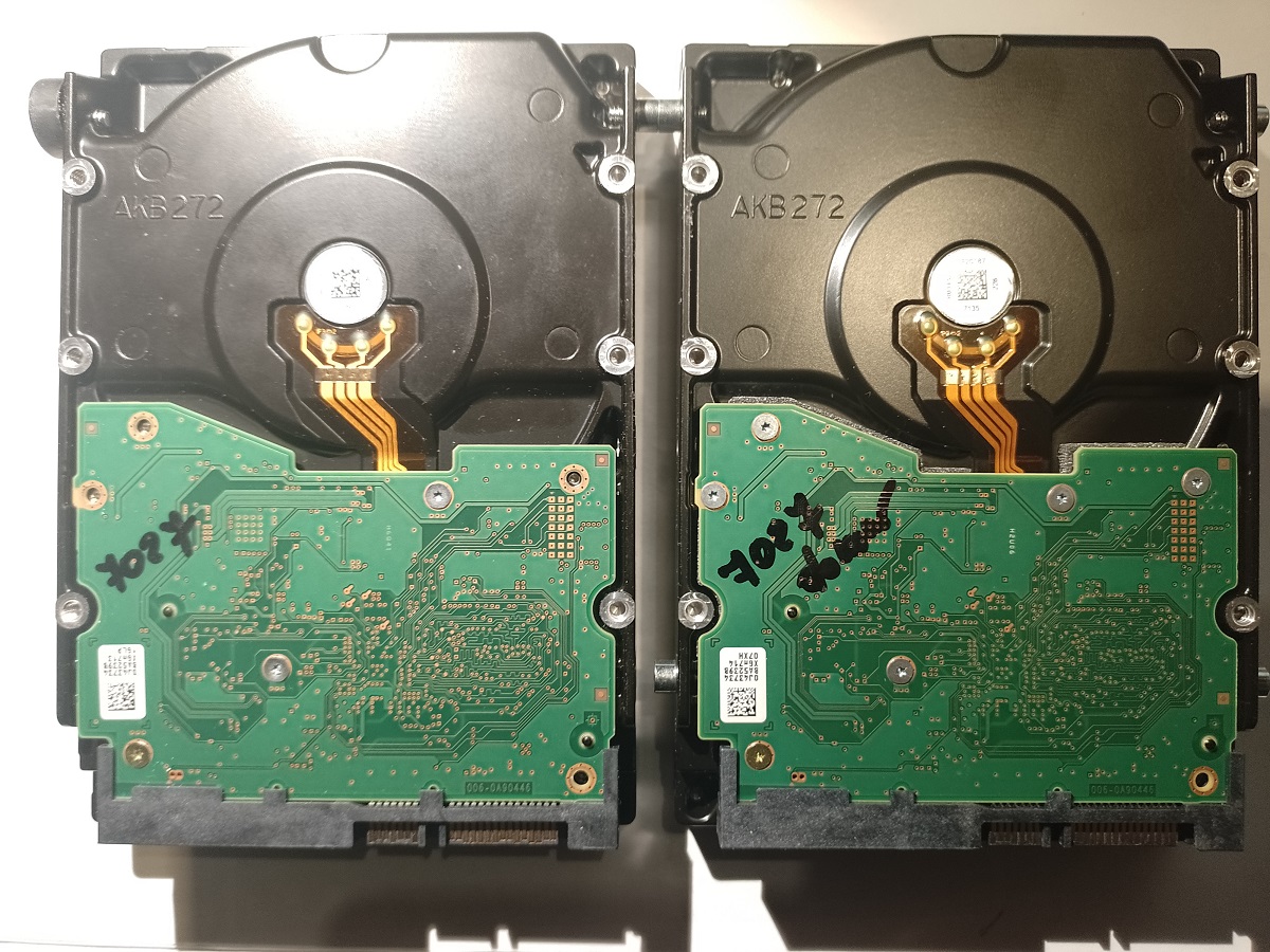

Photo of the front of the patient and donor below (patient and donor - front.jpg).
patient and donor - front.jpg (376.19 KiB) Viewed 9782 times
Photo of the back (PCB) of the patient and donor below (patient and donor - PCB's.jpg).
patient and donor - PCB's.jpg (12.38 KiB) Viewed 9782 times
PCB photo:
Probably ROM chip (1 MB):
