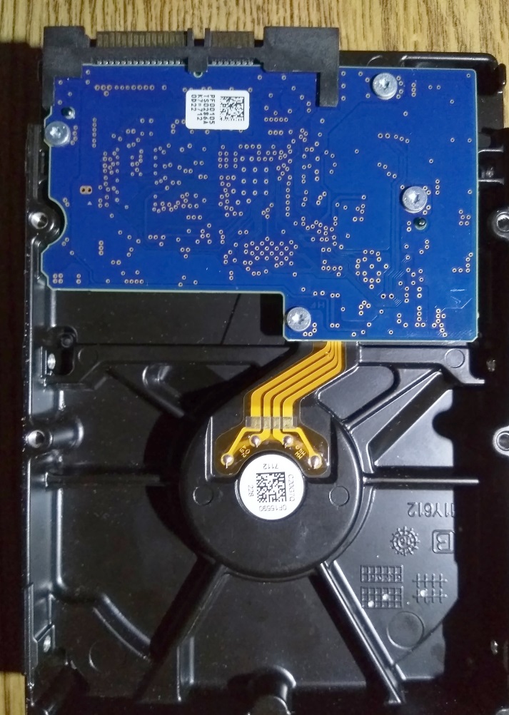

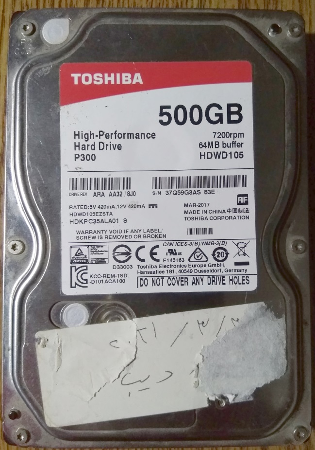

Hi.. Guys
I Received a Toshiba HDWD105 500 GB Product on Mars-2017 from China , it's confuse me a lot to find out his category in Toshiba Family list in PC-3000 UDMA.
I Cannot find the way to create a profile in custom family ( It's not active ), so I tried all Toshiba Model ( No avail ), So I moved to Hitchia-IBM-ARM and all Family models, then i find out a full compatible one HITACHI-IBM-ARM ( Family 7210DLE6 ).
I Backedup Modules , NVRAM, ROM, SA-Structure test , Clear SMART,and final checked platters surface by Logical Scan. every thing going well.
So I'd like to share with you my experience.
Here are in the attachments:
1- HDD Photos.
2- Operations Log
3-Logical Scan Chart.
4-Reports.
5- Firmware
Have a Nice Night
