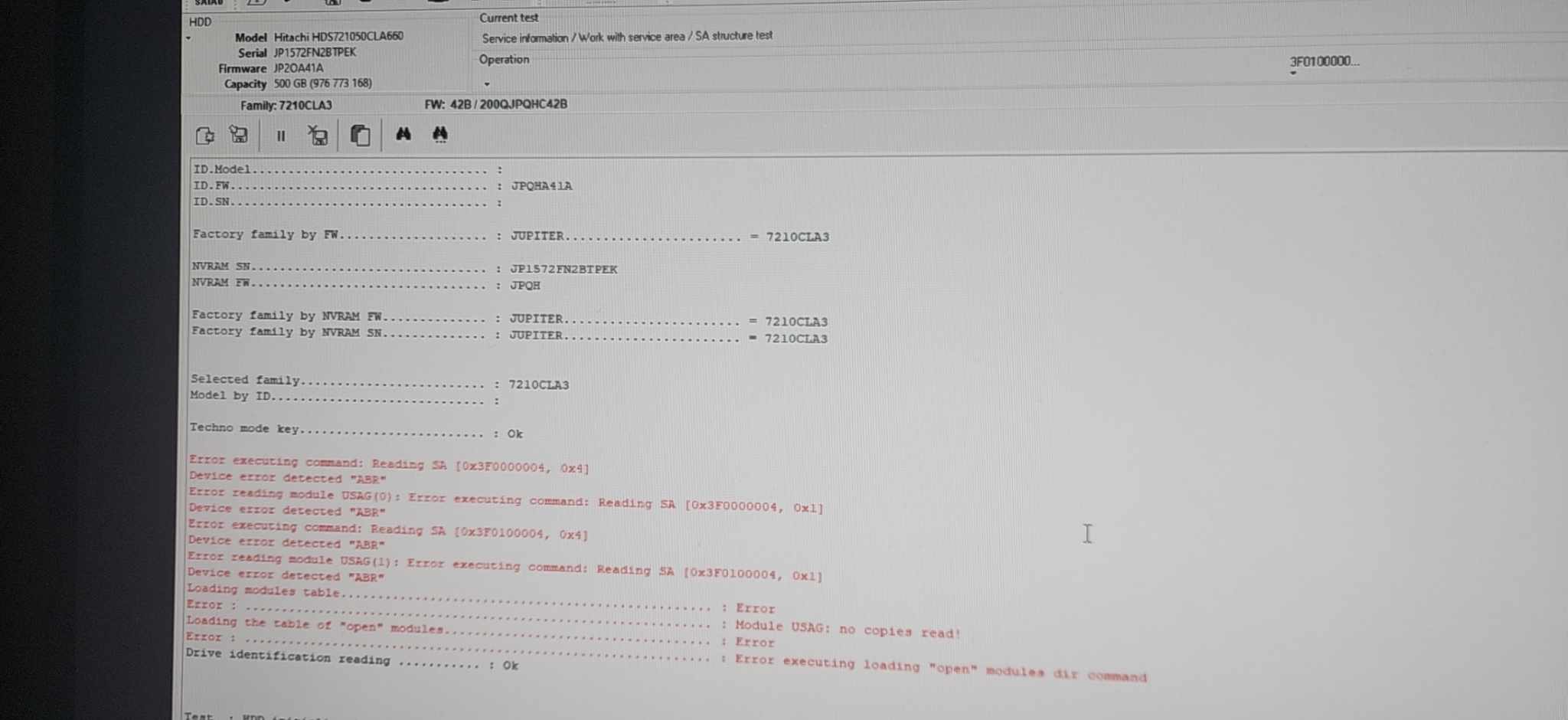

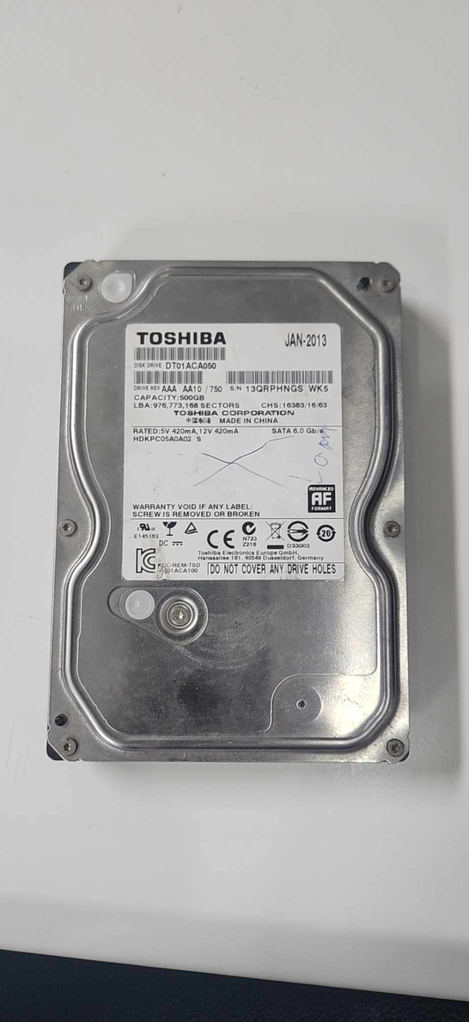

Postby gameboybin » 24.04.24, 09:56
I'm curious about this case also. Got this Toshiba DT01ACA050. Drive was spinning without any noises. Cannot ID. Upon opening utility got this error messages

Re: Toshiba 3tb DT01ACA300 Not reading ID
Postby XiaoShen » 28.12.24, 03:38
The firmware is damaged. After uploading the same version of firmware, the damaged hard drive firmware can be read. Some firmware offsets need to be manually processed
