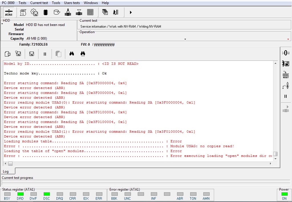

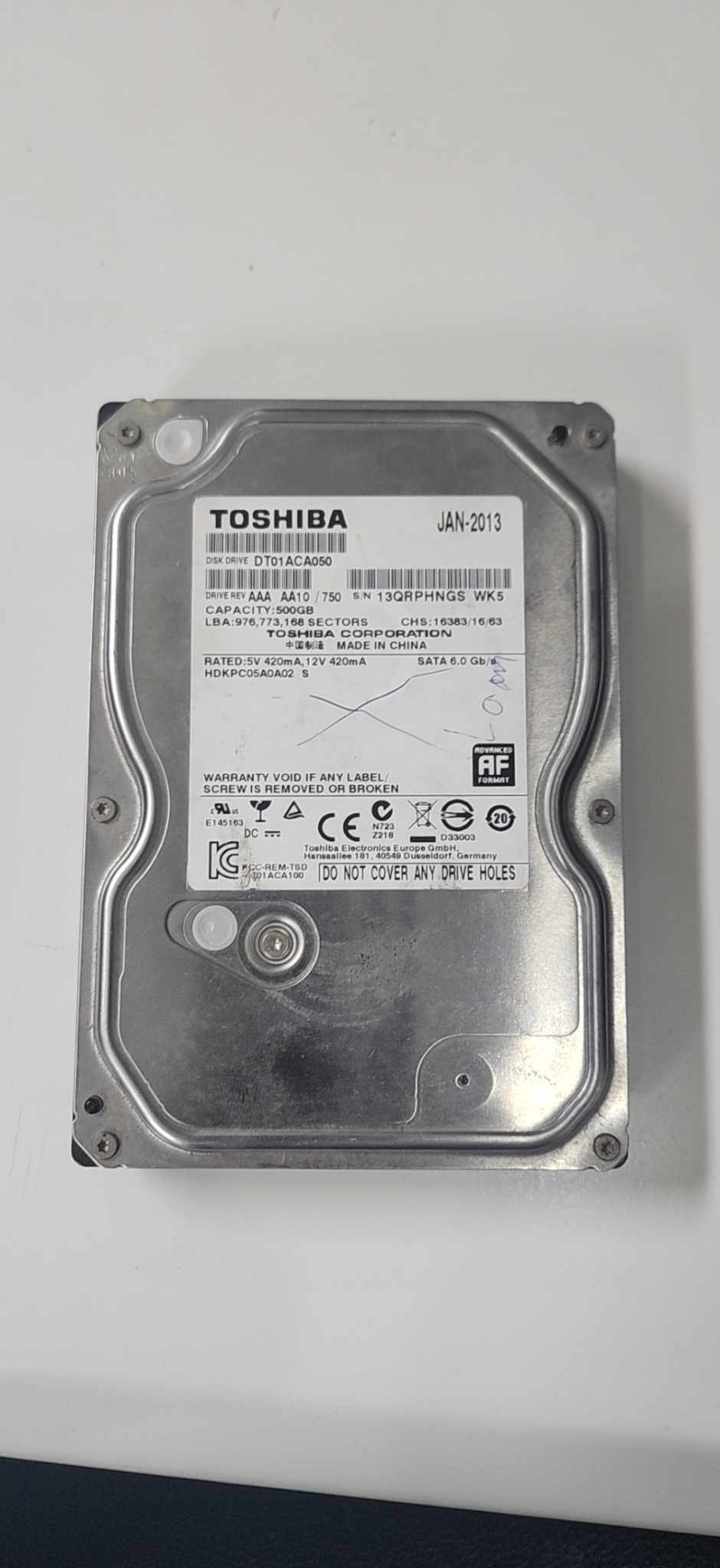

hello,
My Toshiba DT01ACA050 (Hitachi ARM 7210DLE6) drive gives the following error on connection. It also do not show the HDD ID.
Selected family......................... : 7210DLE6
Model by ID............................. : <ID IS NOT READ>
Error startintg command: Reading SA [0x3F0000004, 0x4]
Device error detected (ABR)
Error startintg command: Reading SA [0x3F0000004, 0x1]
Error reading module USAG(0): Error startintg command: Reading SA [0x3F0000004, 0x1]
Error startintg command: Reading SA [0x3F0100004, 0x4]
Error startintg command: Reading SA [0x3F0100004, 0x1]
Error reading module USAG(1): Error startintg command: Reading SA [0x3F0100004, 0x1]
Loading modules table................................................. : Error
Error : .............................................................. : Module USAG: no copies read!
Loading the table of "open" modules................................... : Error
Error : .............................................................. : Error executing loading "open" modules dir command
Kindly help.

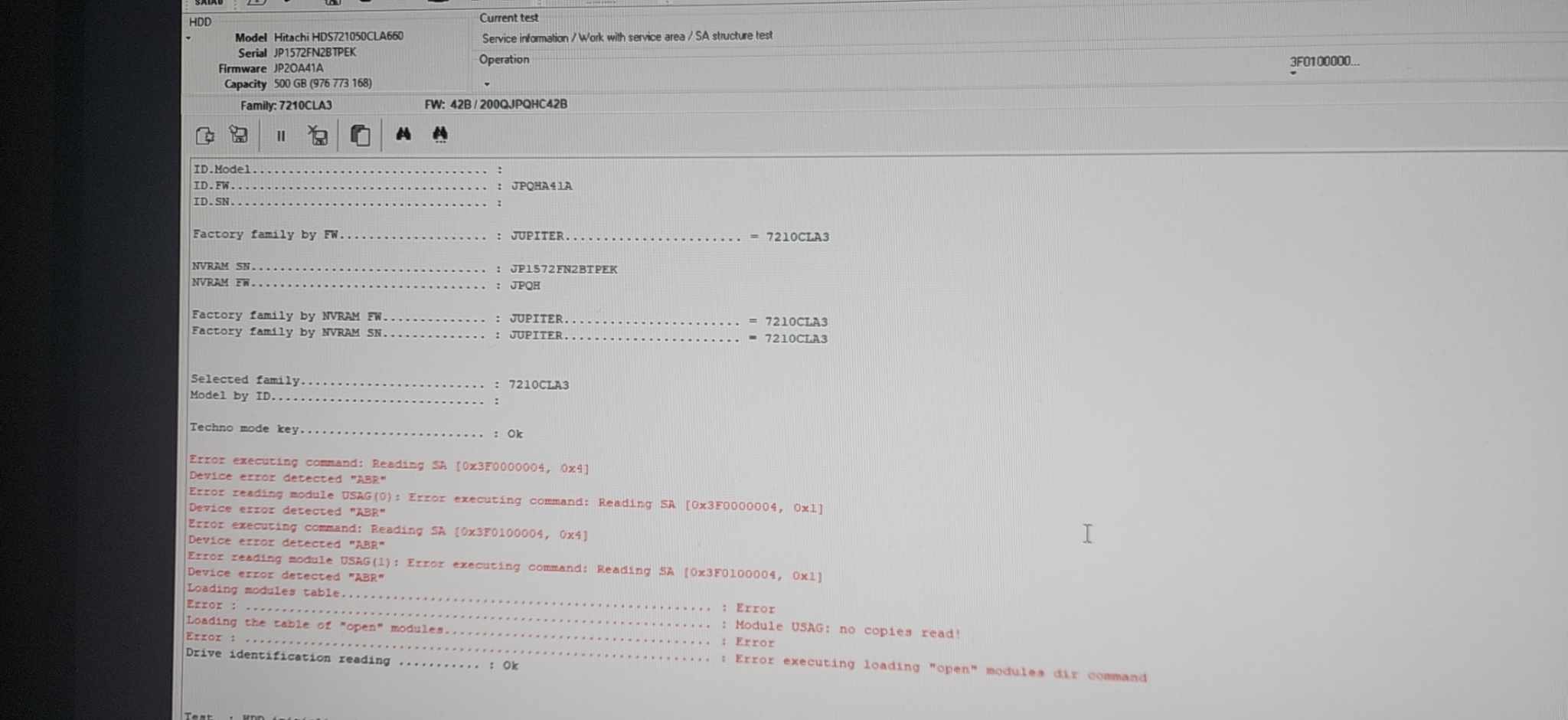

Postby gameboybin » 24.04.24, 10:39
I have the same issue. Even with the head changed. No noise. Drive is spinning
