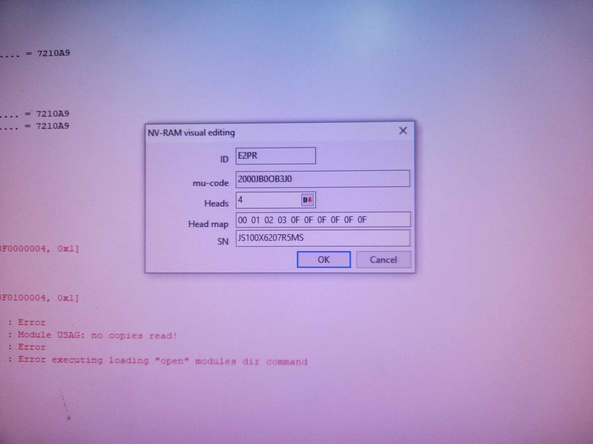

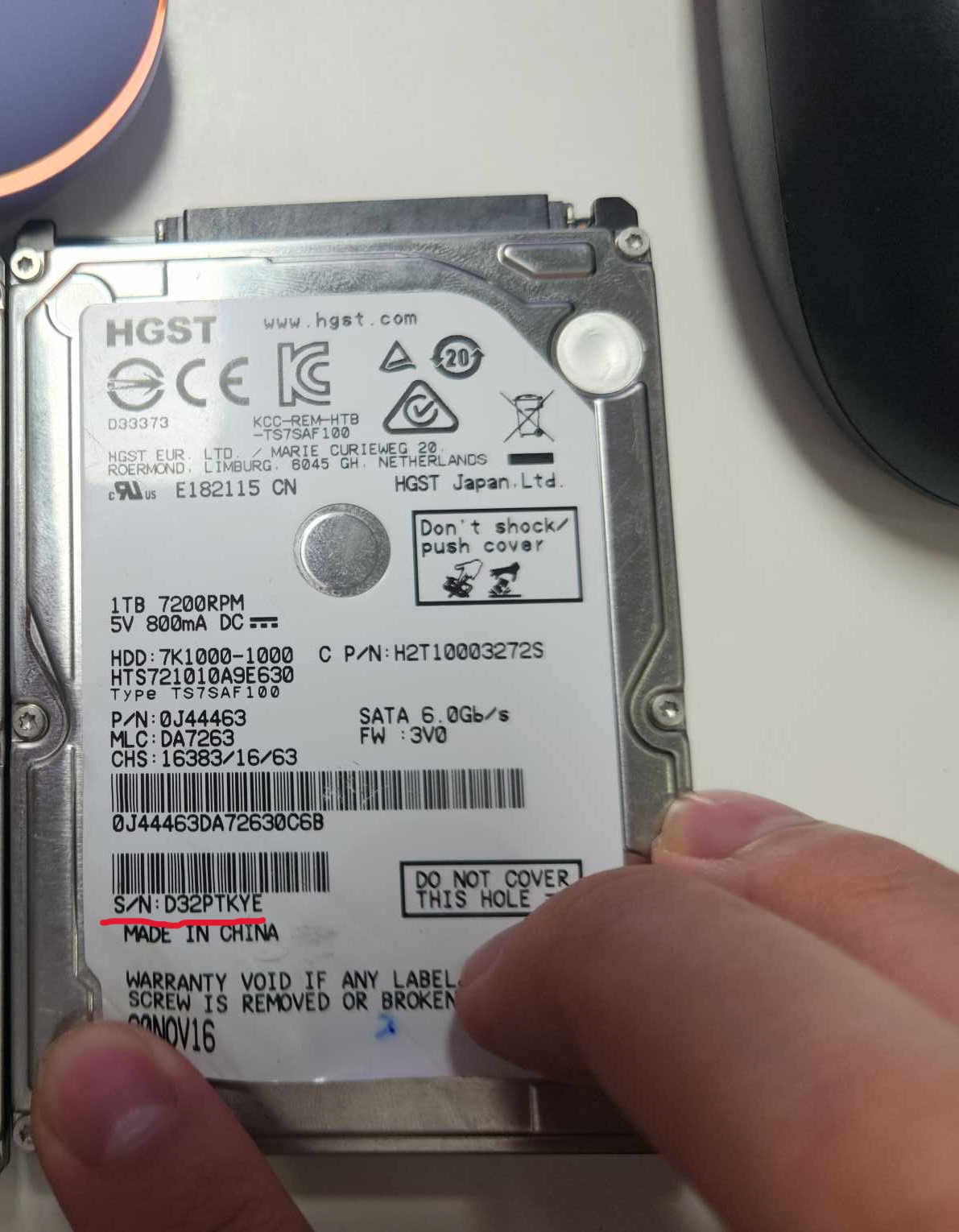

I am sorry. Where do you check your SN on the label. I think mine is totally different
The NVRAM SN is JS100X6207R5MS
But SN on the label is D32PTKYE
which feels strange
Is NVRAM SN from BIOS chip??? because i might misplaced those 2 chips???

Postby gameboybin » 24.11.23, 06:51
These 2 doesn't match
