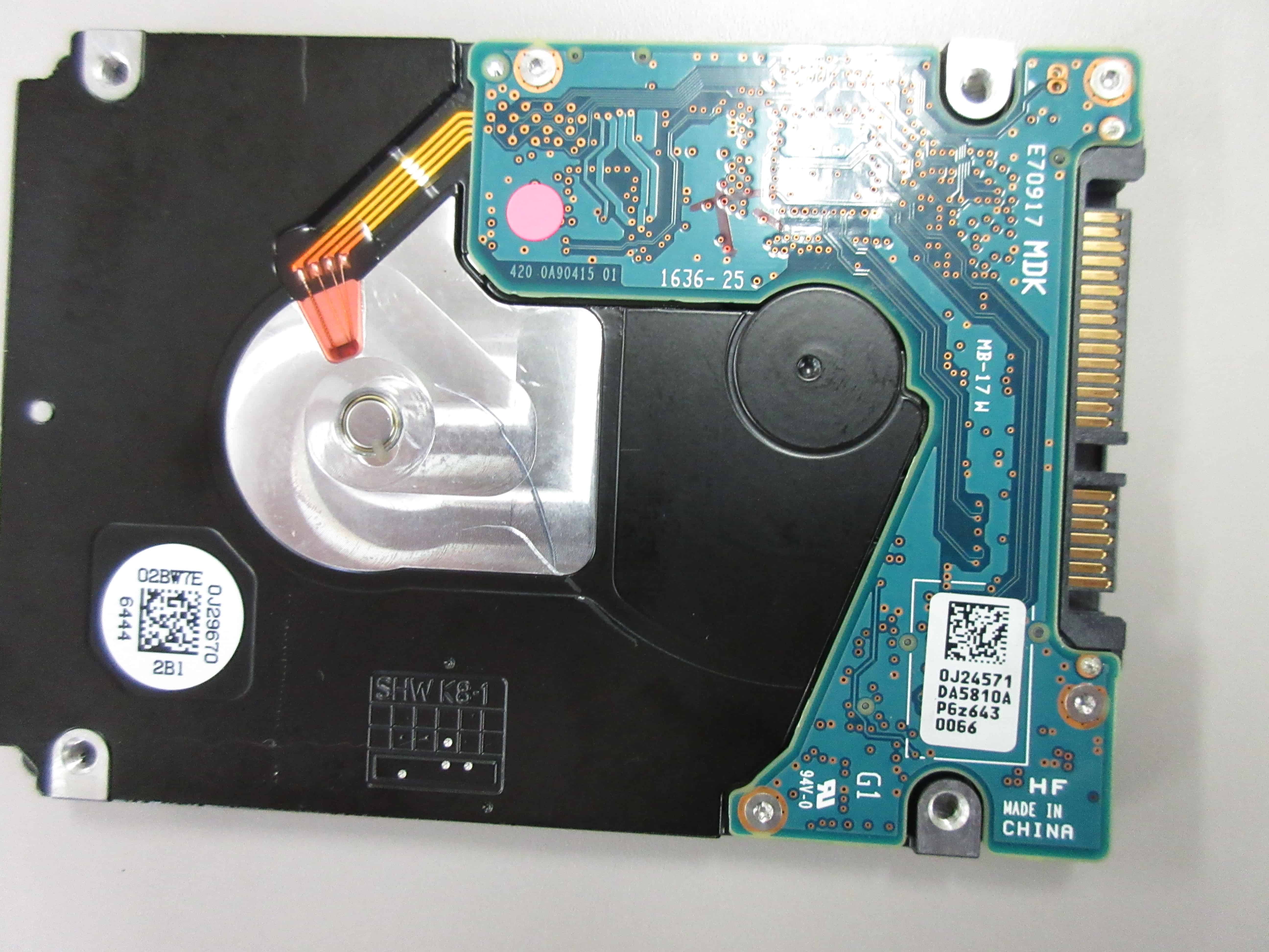

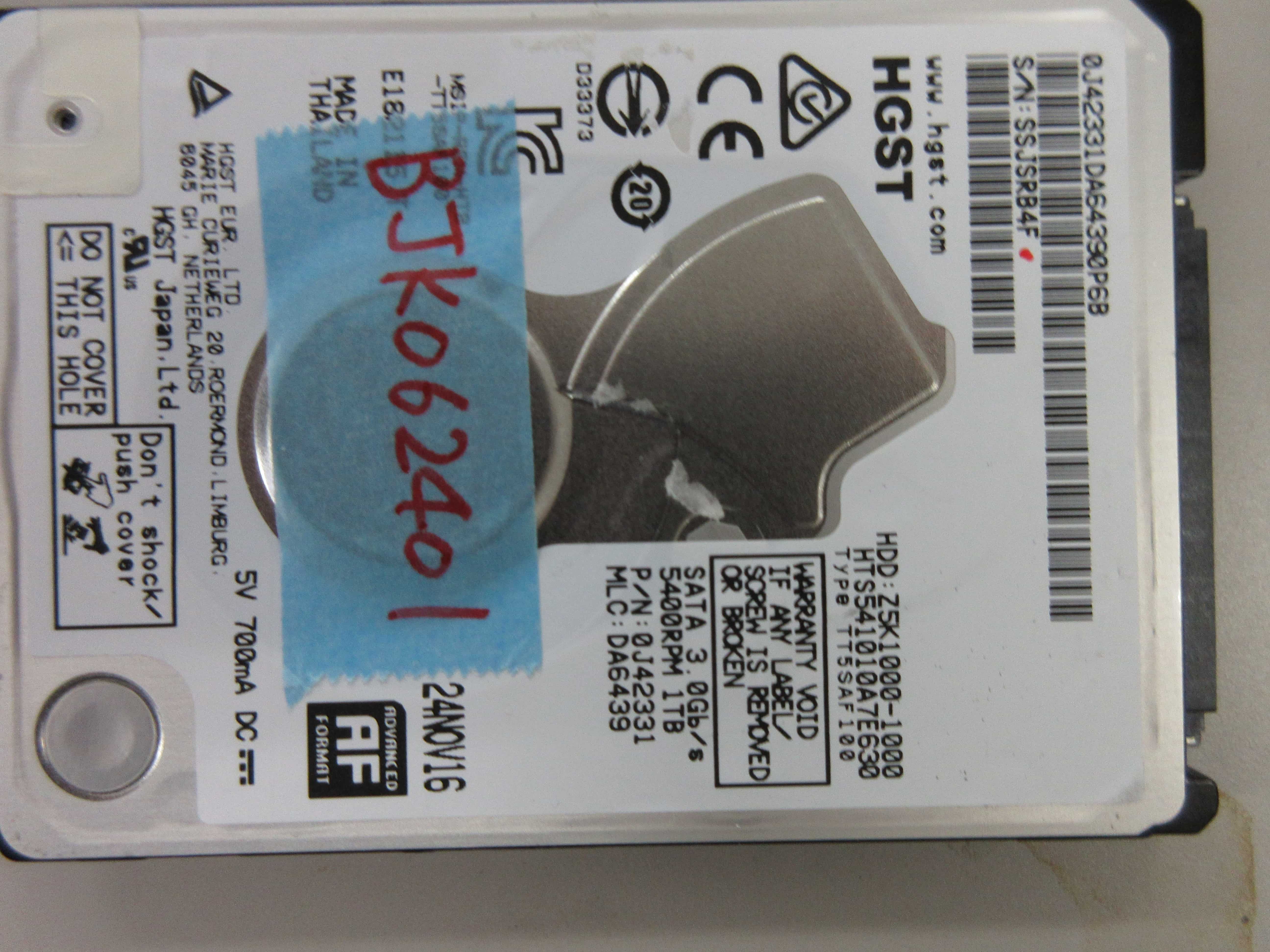

Some additional information, It look like simmer to Seagate rosewood drive or WD slim drive.
bottom view
Top view

These drives have a little bit different way of locking with ATA password.
I don't think PC3K can help just yet. Maybe in the future.
