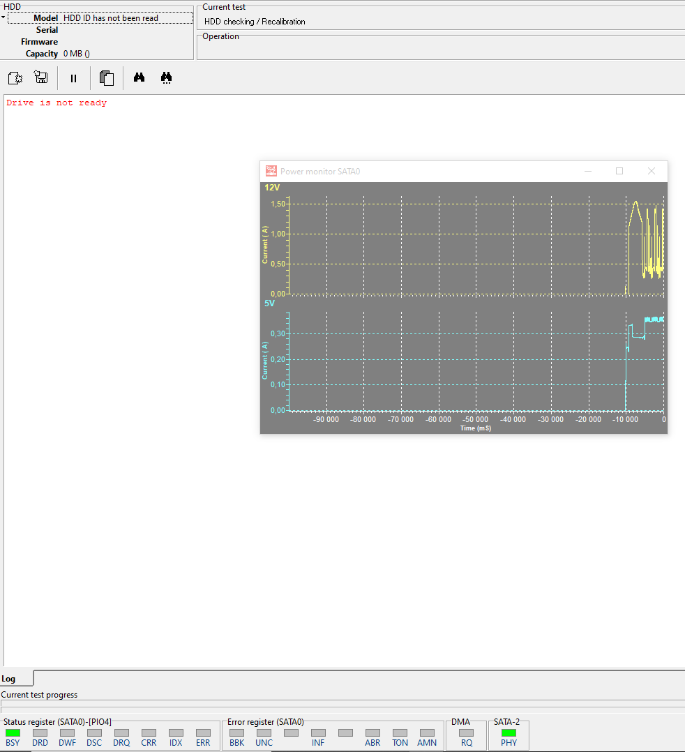

We tried to access to the datas of a Toshiba DT01ACA200. The state is always "Busy" and it's clicking.
We noticed that the heads left the "Park zone" to the center non stop, the surface area don't seem accessible.
Here is a capture of the voltage

RCCU-Brussels, regarding your description it's not a logical problem. I'm more than sure it's a heads failure.
Actually this drive isn't a Toshiba so all actions you did from the article for diagnowstic won't work here.
Good luck with heads swap! :wink:
