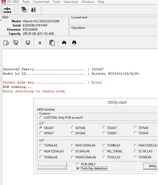

Its Hitachi HCC543232A7A380, i have some drives of 160gb and 320gb.

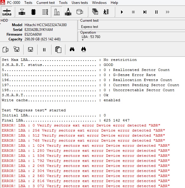

if i connect the drive it detects normal in universal utility, and i can check SMART which is good.
but if i scan, drives shows ABR from 1st to Last sector.
now if i select Hitachi-ARM utility, i have to manually select 5432A7 with Tech Key checked
it gives error switching to techno mode

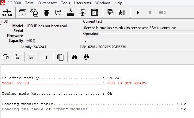

i connect the pcb alone and did NV-RAM edit from 00 01 to 00 00,
now drive is giving access to SA with head 00.
