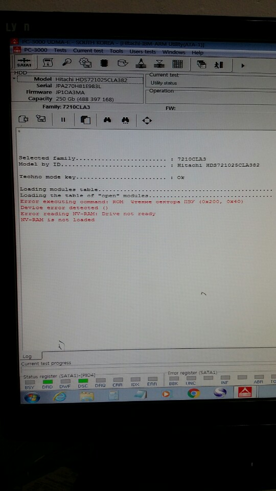

on latest pc3000 express,
Normal hds721025cla382 not detected properly.
Maybe bug.

OHMYDATA, Thanks, we have already known about this problem, hope it will be fixed soon. At the moment you should use previous 6.2.23 version to operate with 7210CLA3 family. :!:
Sorry for the inconvenience!

Good, so it's not just me. You can just power off/on after this error and it will work as expected, assuming it's in good shape.

Bug has been fixed in 6.3.15 version which is already available via personal update boxes! :umnik:
