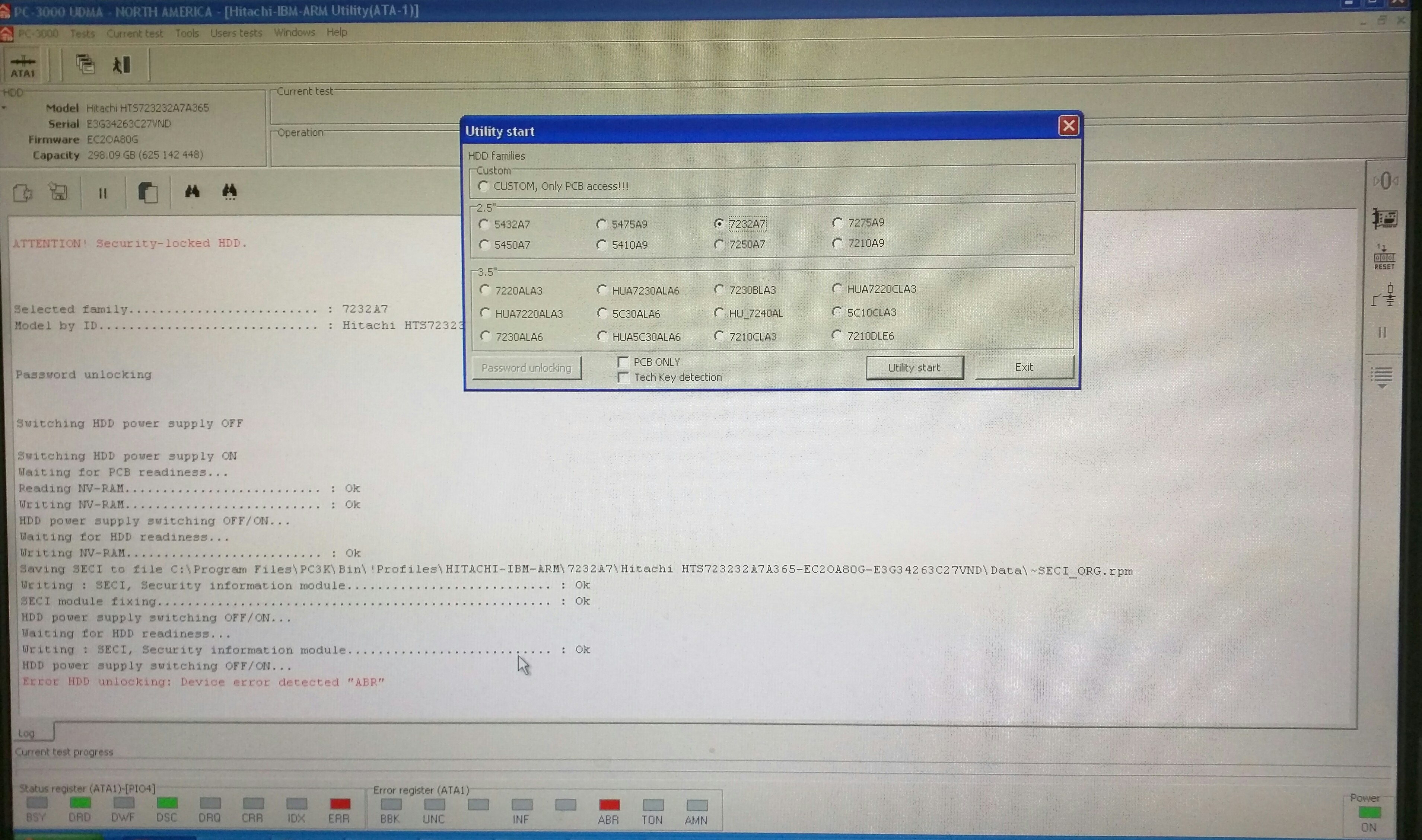

Subject: another locked hitachi - got it unlocked but its all zeros
HTS723232A7A365-EC2OA80G-E3G34263C27VND
security locked drive
I manually backed up rom and nvram before attempting unlocking
I ran through the unlock procedure
its was going as expected
it backed up nvram and seci
then it ended with abort error
I exitted the util and went back in
did tech key detection
exitted and went back in
drive is detecfed and appears to be unlocked.
I backed up SA
I can read data
however - ENTIRE DRIVE IS ZEROS 0000000000000000
could the unlock attempt have mad the drive security erase itself?
I wrote the saved seci-org back to the drive
i wrote original nvram back to drive
now it appears as it was security locked
did this cause the drive to erase itself
or act erased?
there wasnt enough time for it to erase itself.
I dont hear noises like the drive is busy erasing - so what do you think?
heres the screenshot of the progress
