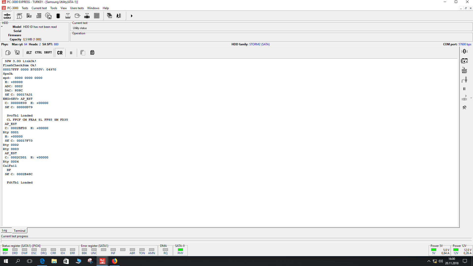

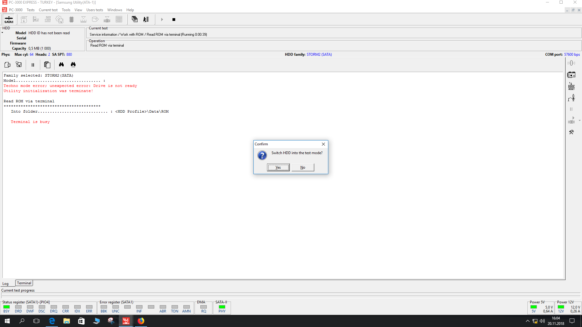

disk is bsy, i can't read the rom
What can be the issue?

issue could be with SA, a hotswap can help you further diagnose it.
