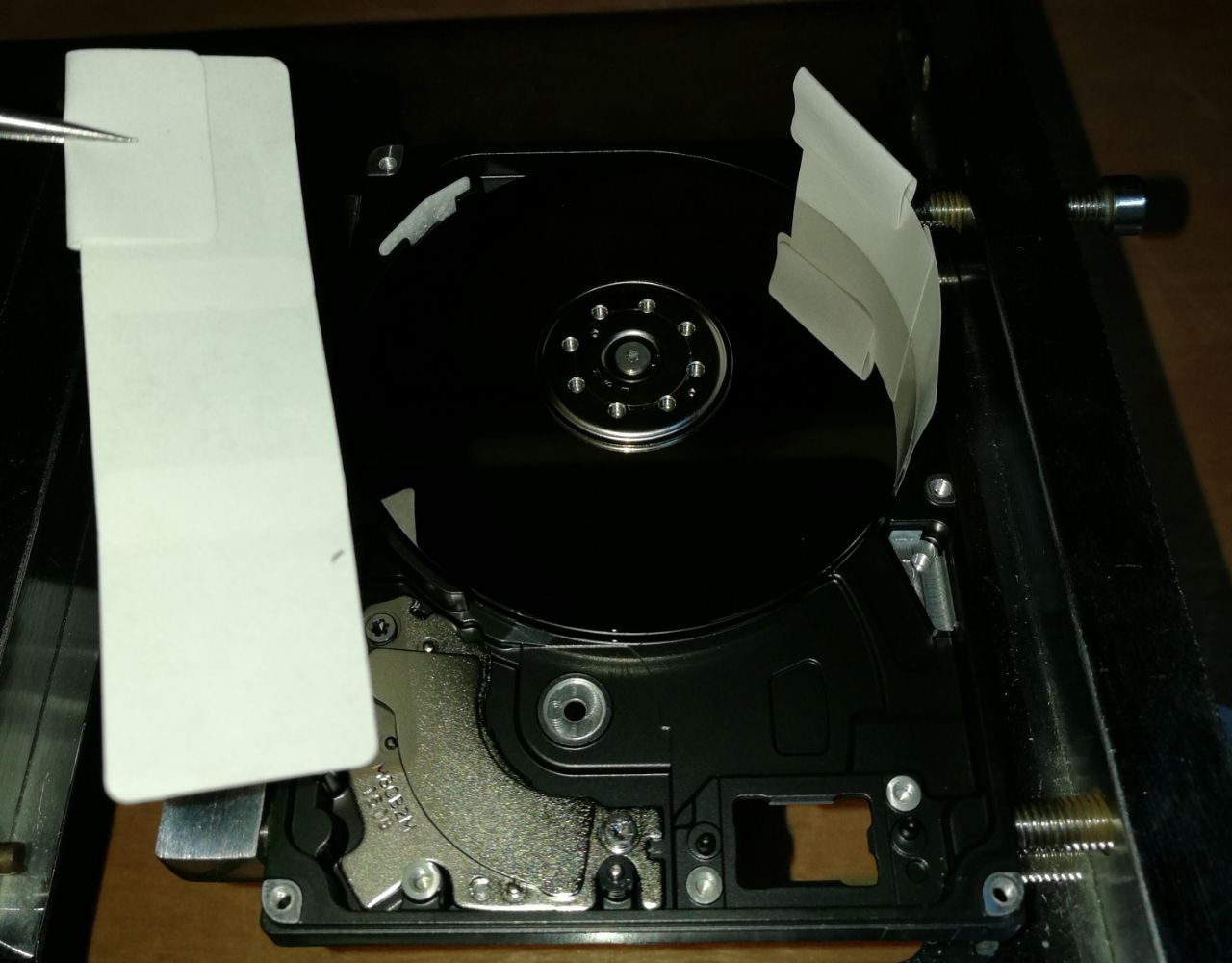

I have 1TB Samsung HNM101MBB drive for data recovery. bottom 2 heads 0-1 are with out slider. After looking closely inside the platter those sliders are stuck to platters.
I tried to shake the drive to remove sliders but it could not come out. Is there any way to get those out so that I can replace the heads and read the drive.

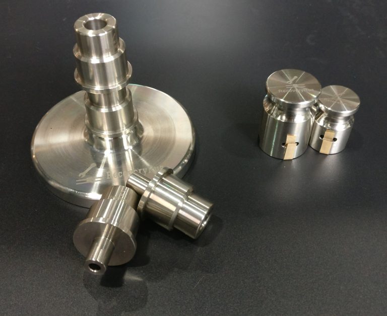

I am planning to get below platter extractor and holder for 280$. my questions are 1. removing the platters and putting back what precaution I need to have? 2. Do I need to keep the vertical alignment accurate or little bit offset will work? 3. Are these platter holders safe for platters as these probably hold platter by magnet.

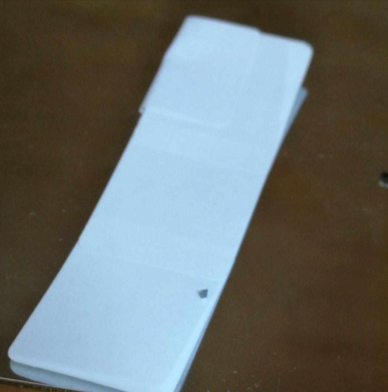

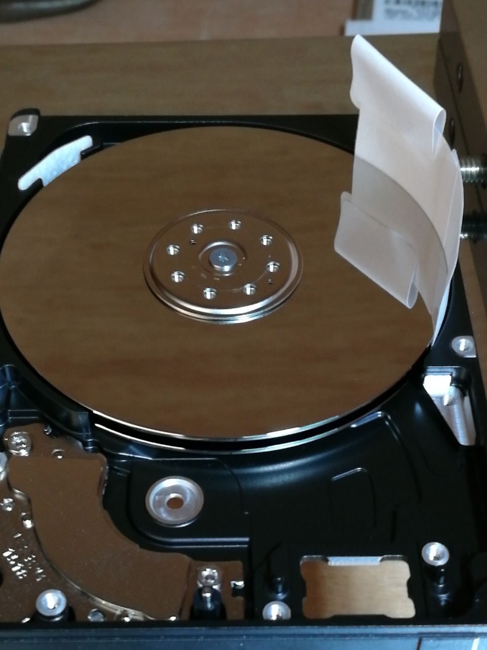

Removed platters with the help of stickers, used the plastic stick to remove the slider and that's it.

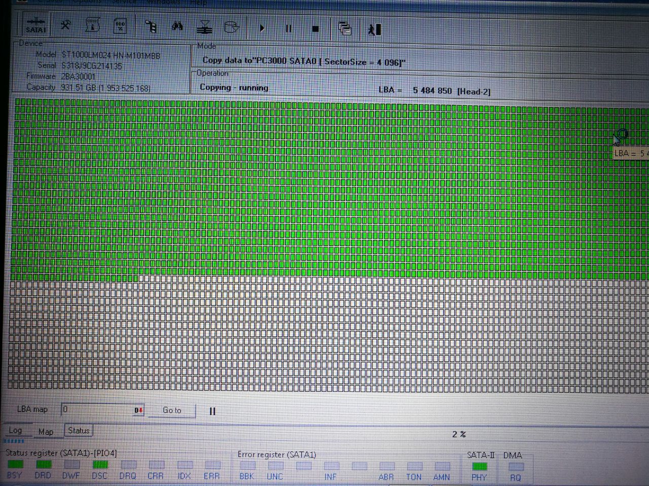

Drive now imaging. :D
