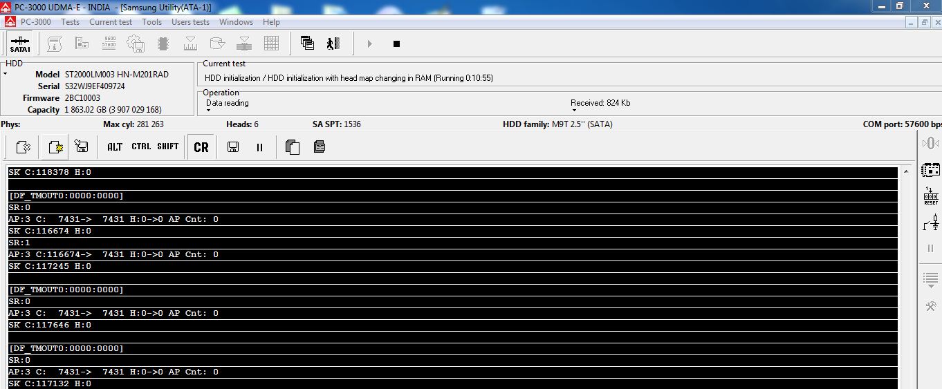

SK C:118378 H:0
[DF_TMOUT0:0000:0000]
SR:0
AP:3 C: 7431-> 7431 H:0->0 AP Cnt: 0
SK C:116674 H:0
SR:1
AP:3 C:116674-> 7431 H:0->0 AP Cnt: 0
SK C:117245 H:0
SR:0
SK C:117646 H:0
SR:0
SK C:117132 H:0
Head Bad
this case samsung head stuck
samsung head bad case

Re: samsung head bad case
This drive haven't something errors about dead head(s).
Try to check users area access. Whole area is not accessable?
Try to initialize drive with changed Head map, check 0000... and 1111... head map.
