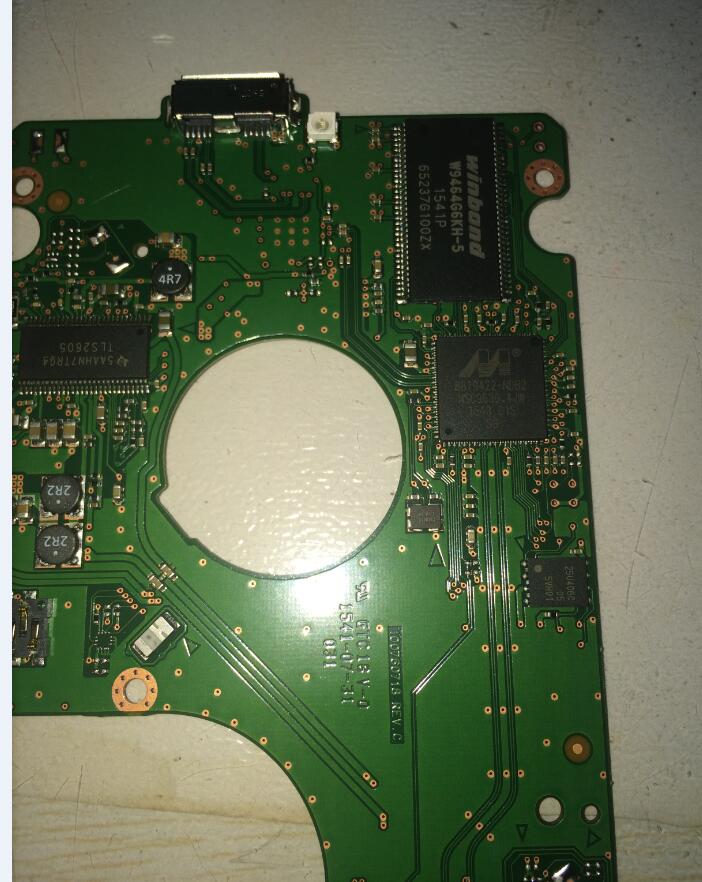

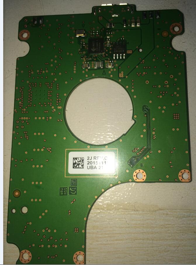

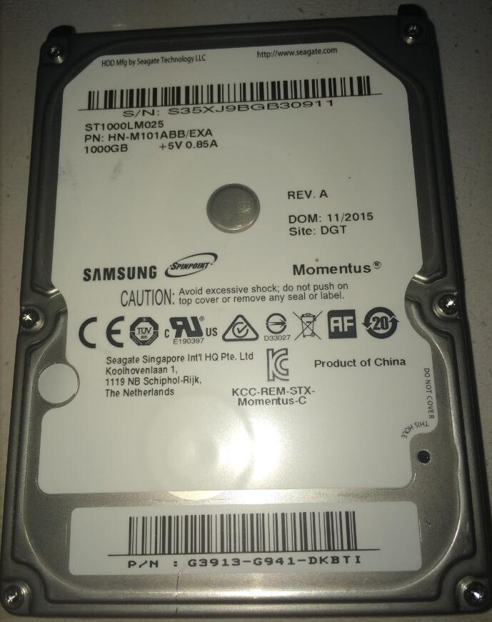

Model ST1000LM025 PN:/HN-M101ABB/EXA
CPU :88I9422-NDB2
USB Chip: JMS577
PCB Info :100760718 rev.c
replace to sata

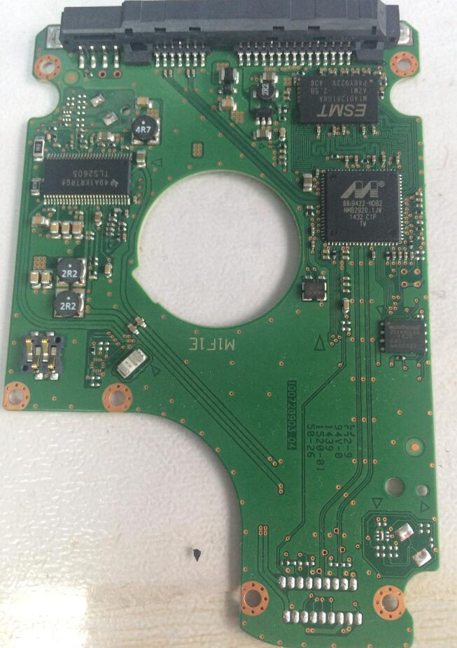

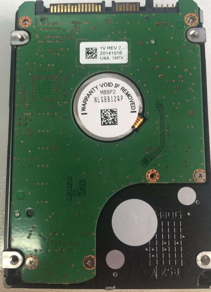

CPU:88I9422-NDB2
PCB info : 100720903 04 PCB label Rev.7
ST1000LM025
