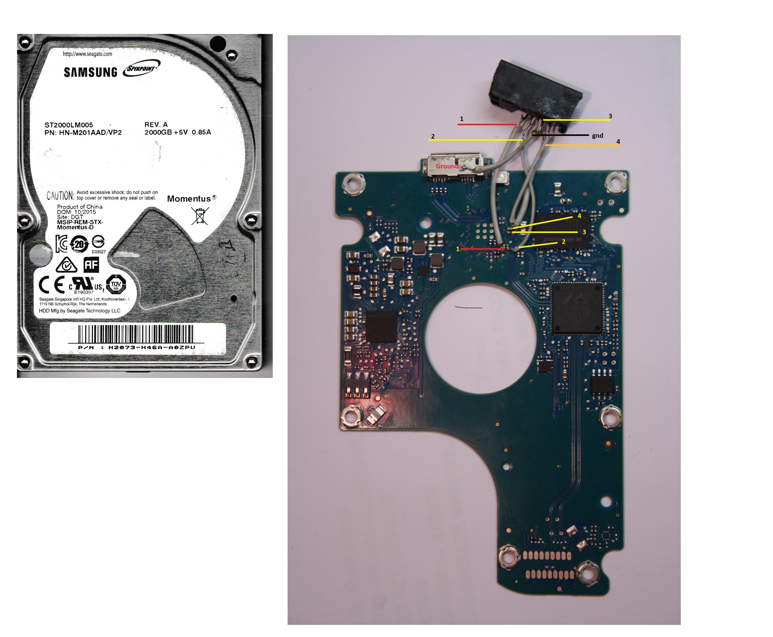

Please find attached pin out for Samsung SAMSUNG HN-M201AAD/VP USB PIN-OUT
samsung USB pinout.jpg (924.49 KiB) Viewed 15891 times

Compatible SATA PCB: 100731207 REV A

In theory any SATA PCB from same family and with same processor would be compatible

In theory :) - i hope that is too in practice :)

Here's a list of confirmed ones that's we've started compiling: https://www.data-medics.com/forum/samsu ... t1438.html
