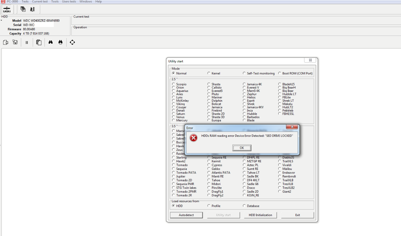

It came in clicking. I changed heads and drive would spin up fine and ID but report that it's SED locked.

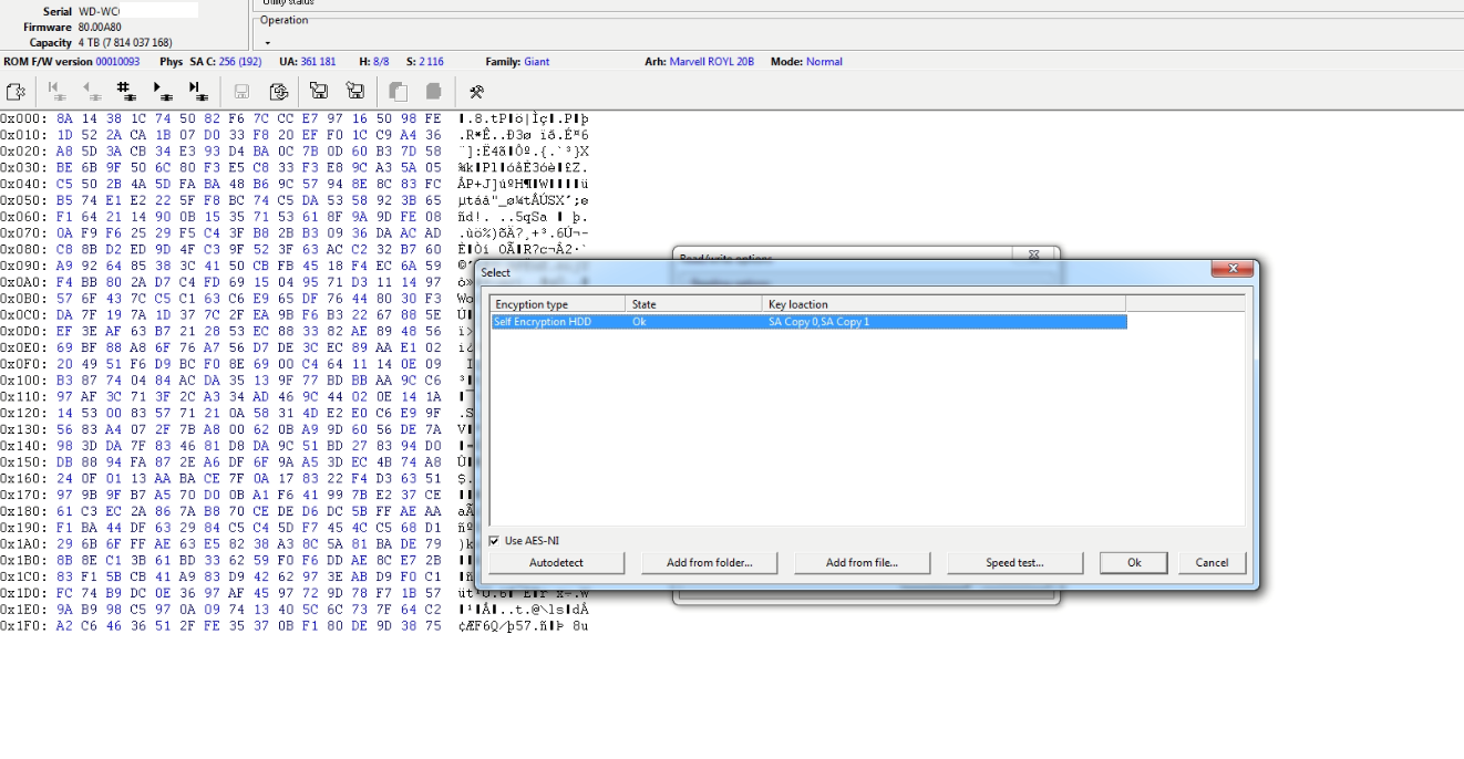

I followed usual procedure and PC-3000 correctly sees the SED key.

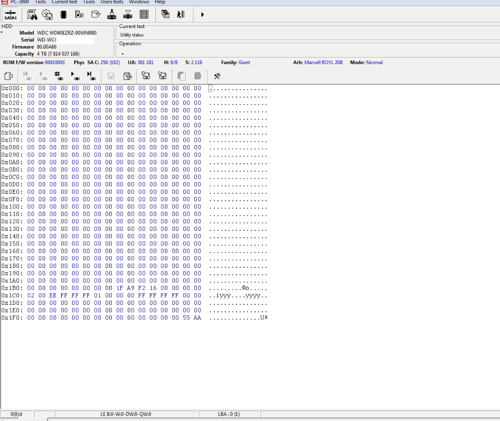

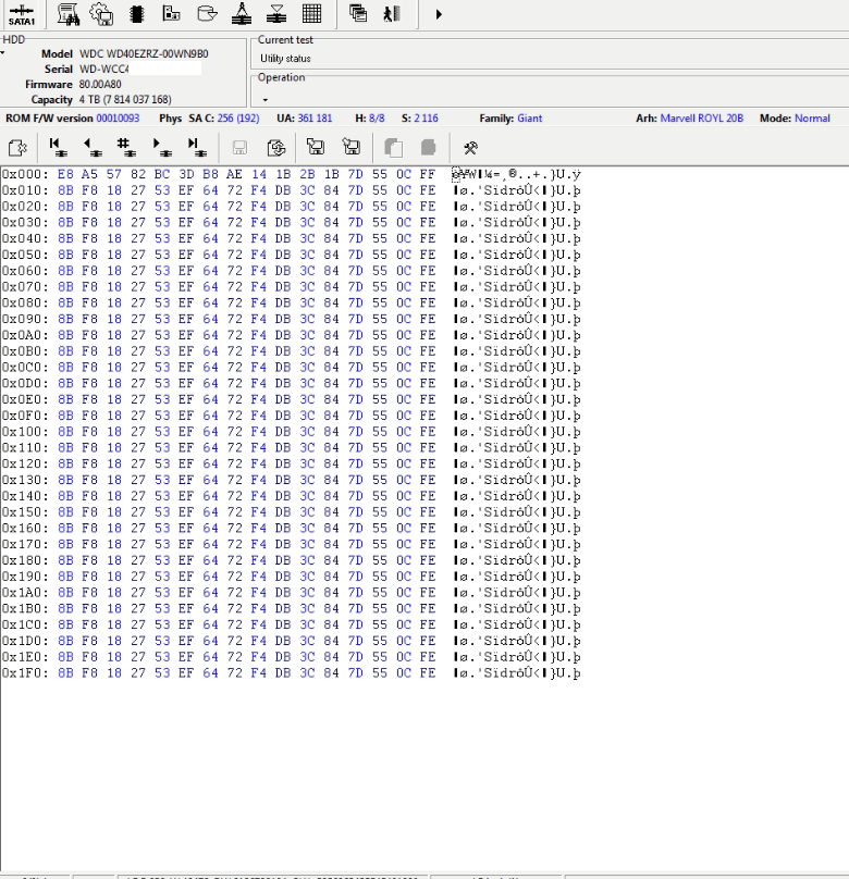

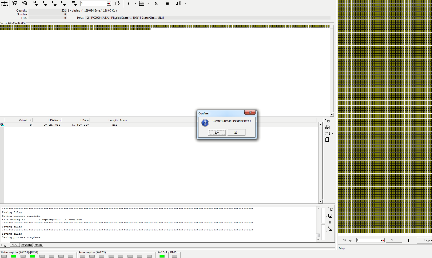

After selecting this, sectors 0 and 1 would look like this:

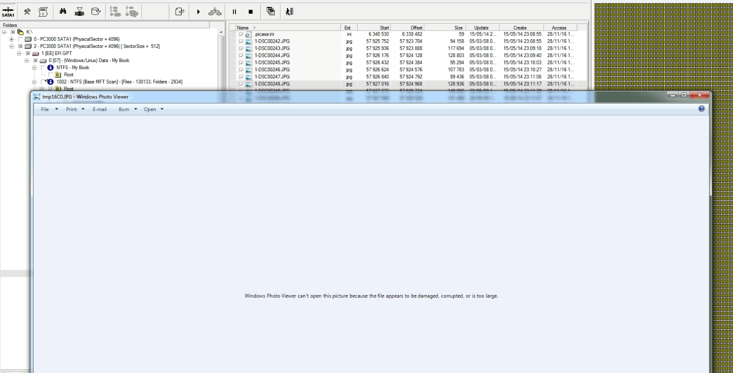

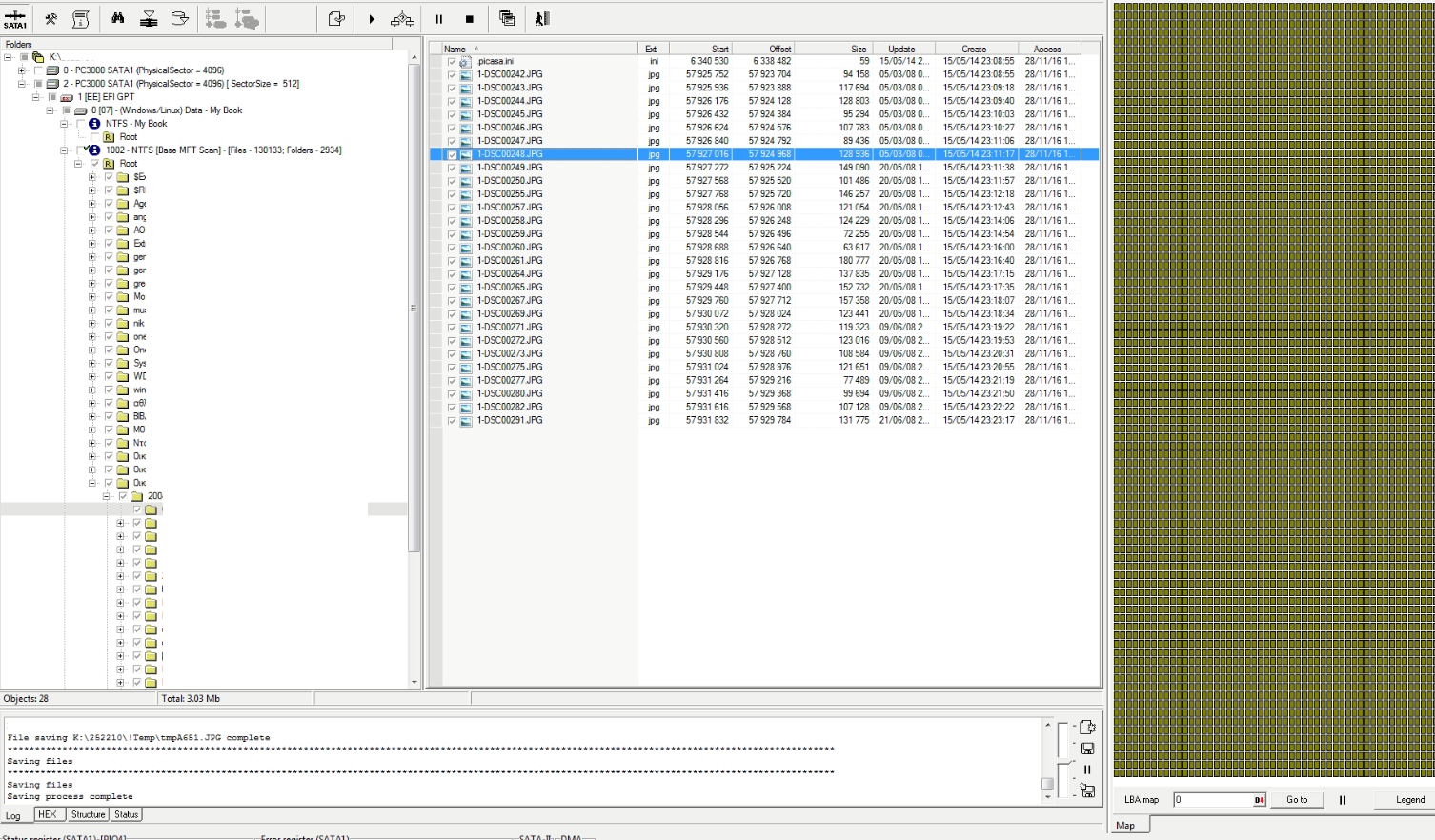

In DE, I can see partition with full structure.
I imaged the partition without problems, but when I try to open the files, they do not work.
However the map of that particular example file looks ok (no bad sectors).
This is the case with 99% of the data. Some of the data DO work.
Is it shifts related? I noticed that the files that DO work are located at the very beginning of the drive, BUT there are a few that are in the middle that do work as well.
