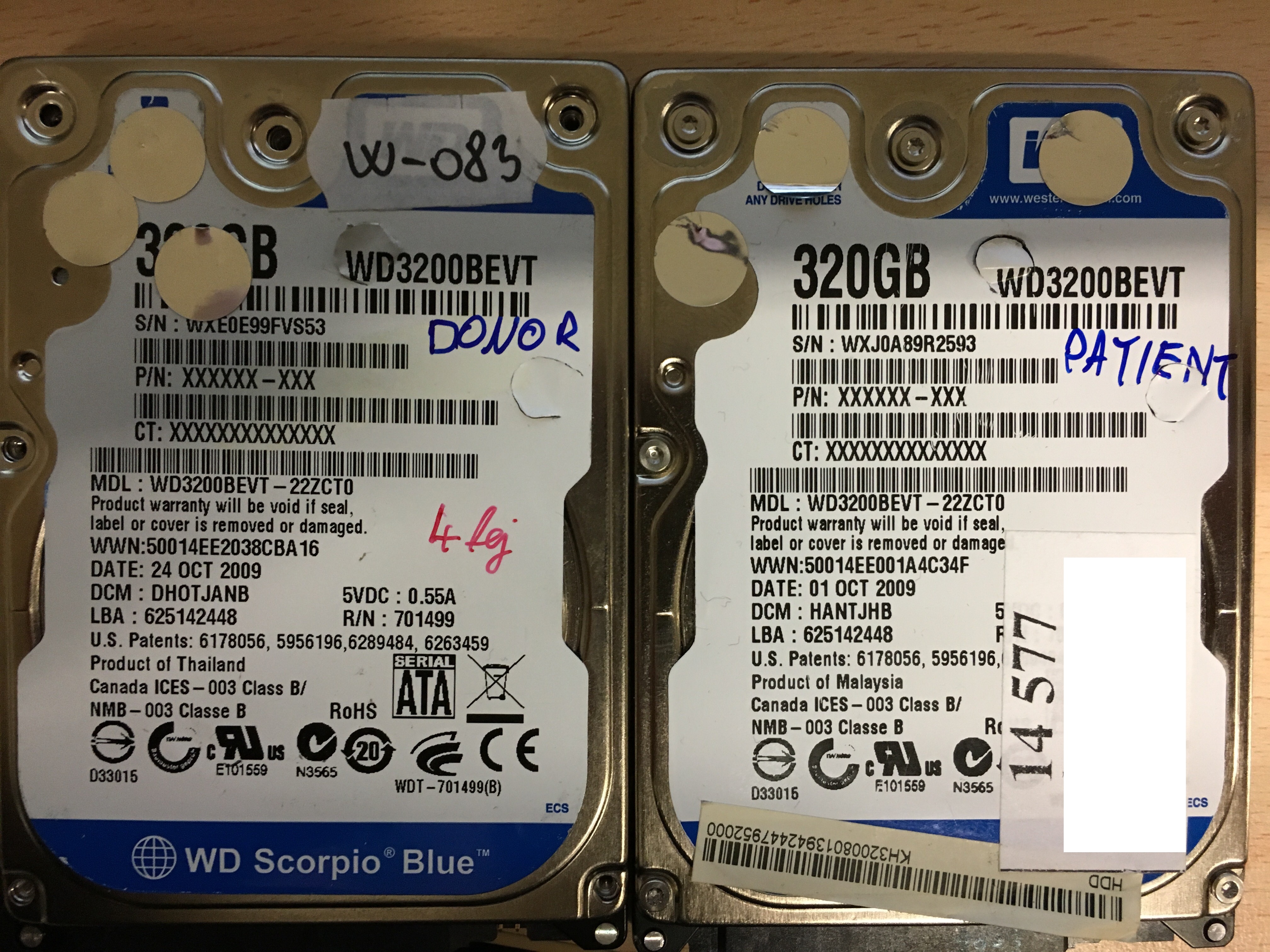

I attached a photo from the patient and the donor.The adaptives diferents are less then 100 and I make avaraged of them. The spindle is stopped after ready with error, it was the same with it's original head, this reason i couldn't read modules by id.I also try upload dir&ldr from its own SA but it is fail. I will try the trick with the ROMs and try to read the modules, i will write a reply with the results. Is hotswap works with this rom trick? Asking because this was my first oppinion, but i didn't find suitable donor..

If spindle stops with DSC DRD then blocking regions would not help - this would help in cases where ERR register alone is displayed after spindle stopping. Donor selection looks good to me. At this point you cannot rule out poor quality donor, errors with the swap itself, or potentially there are some surface read errors.
