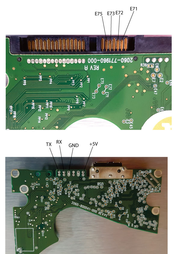

Postby Amarbir[CDR-Labs] » 21.02.17, 06:34
300ddr wrote:Source of the post No terminal port. May try wiring one on if there no other option, but soldering for me is a last resort.
Its There ,
First Two Pins

For SATA connections you have the usual E71,E72,E73 and E75 and the remove the 4 caps between MCU and JMS569

digitalsupport wrote:Source of the post For SATA connections you have the usual E71,E72,E73 and E75 and the remove the 4 caps between MCU and JMS569
I had this information when i searched yesterday ,+ this is easy to do in this pcb as pads are there on non component side of the PCB .I plan to wire Power + SATA Both For Conversion
