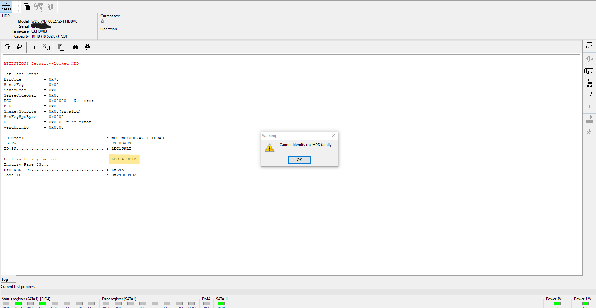

Hello we have a
10TB - (Hitachi/HGST Drive) LEO-A-HE12 family
Model - WD100EZAZ-11TDBA0
Thailand
24 Jul 2019
R/N - US7SAL100
P/N - 2W10206

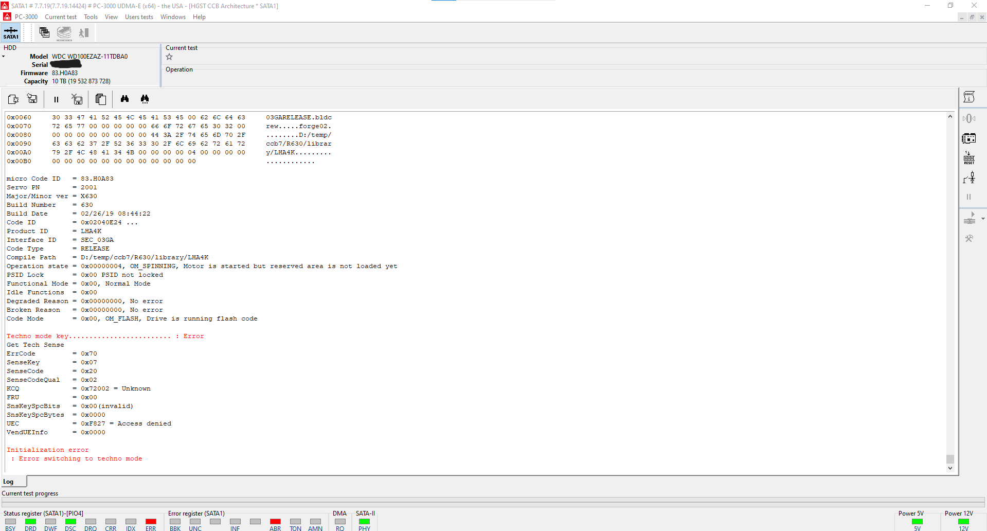

This is a CCB drive in which we have the PC-3000 UDMA. In the utility, shows the family as LEO-A-HE12 but keeps giving error trying to boot to techno mode in the utility. I cannot get past it,
any suggestions would be appreciated

Re: WD100EZAZ-11TDBA0 (Hitachi/CCB/Helium)
Postby AJ2008 » 05.12.25, 18:00
SA is not loaded, I guess you have other issues with it

Postby Hddex » 12.12.25, 19:11
AJ2008 wrote:Source of the post SA is not loaded, I guess you have other issues with it
Yup, confirmed a head issue as heads are faulty and cannot read anything from the surface, so the SA modules were not loaded from the surface and the HDD only works with ROM.
