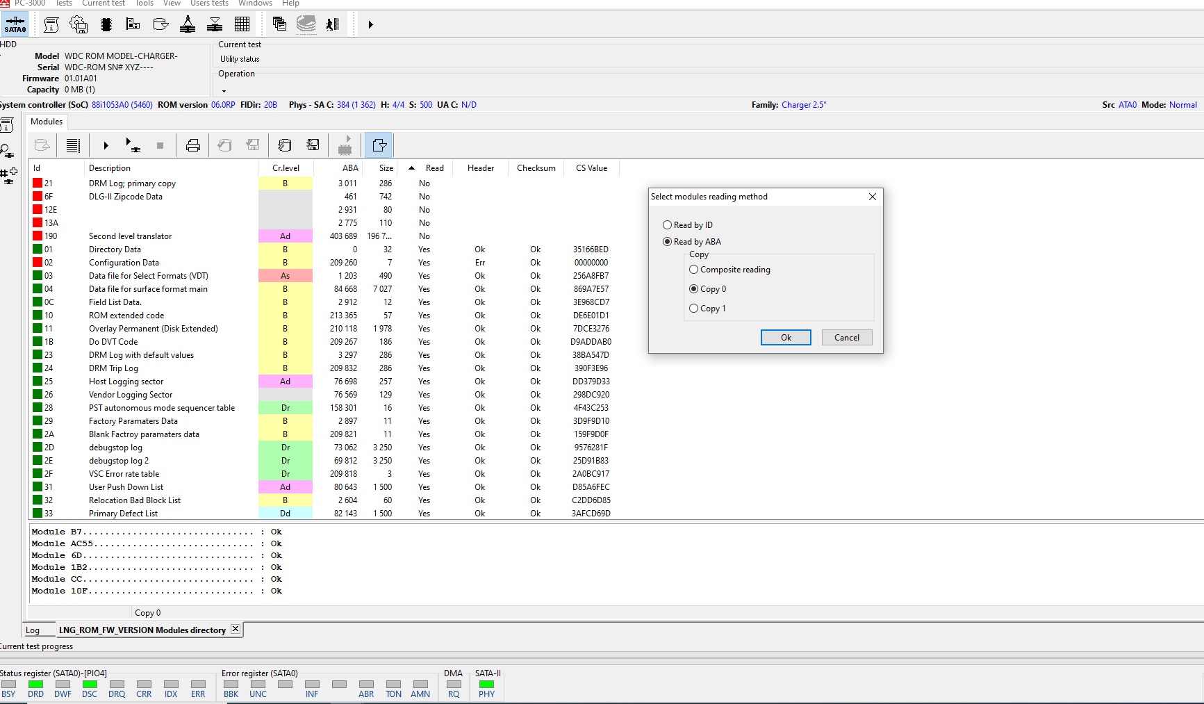

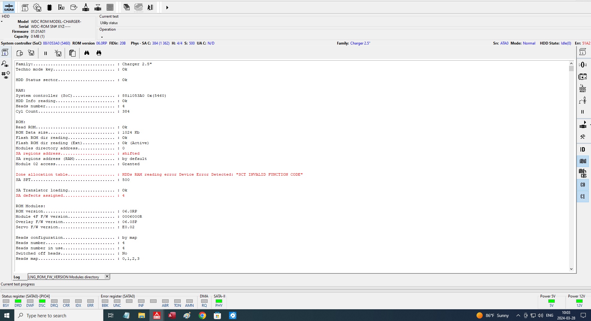

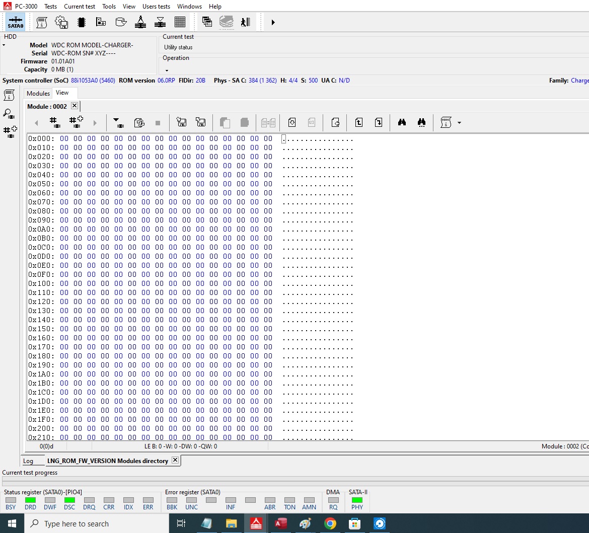

I have a this WD20SDZW-11Z3CS0 hard disk. and i found problem module 02 bad in both SA copies.
Help me to solve this problem.
check attachment pictures.
Thanks.
ROM Modules:
ROM version............................. : 06.0RP
Module 4F F/W version................... : 0006000R
Overlay F/W version..................... : 06.0RP
Servo F/W version....................... : E0.02

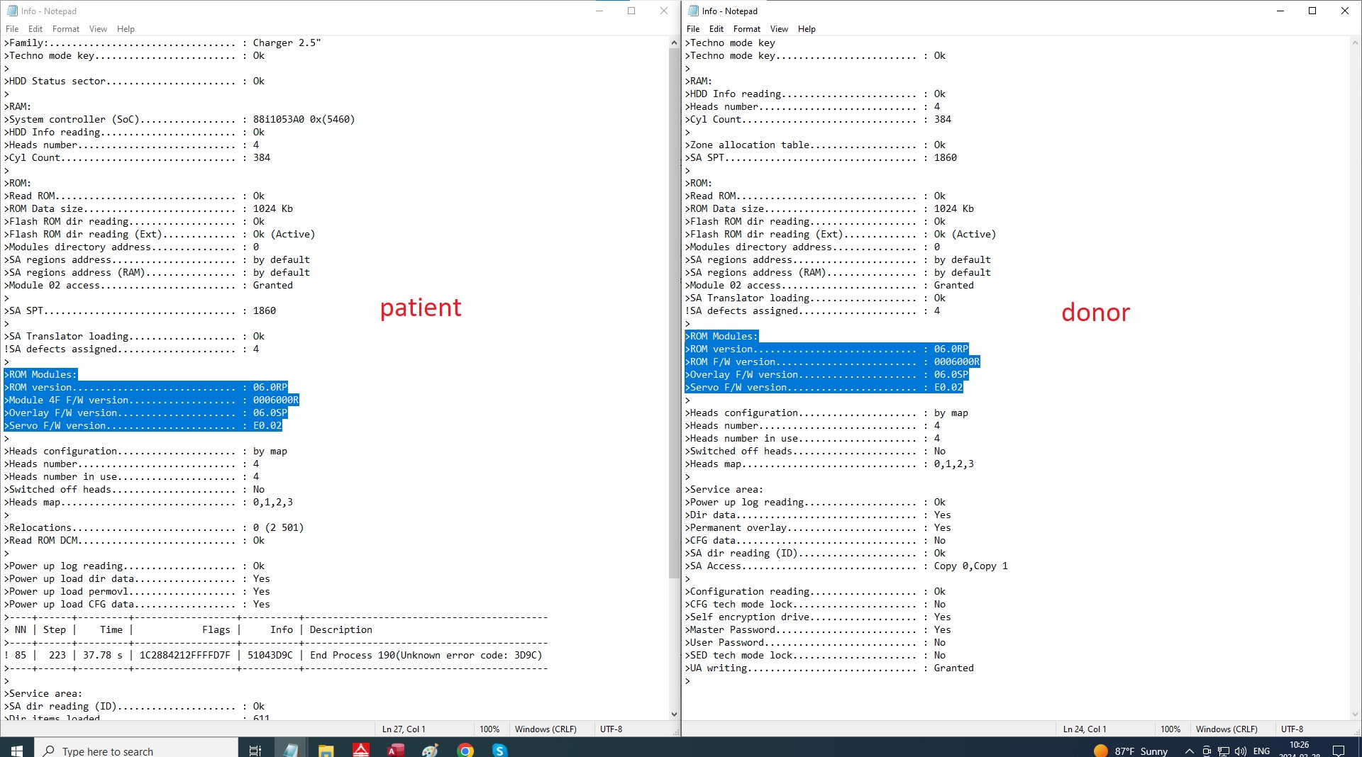

take 02 from donor resources.

ajay.mudhgill wrote:Source of the post take 02 from donor resources.
Hi, thanks for your reply.
What is the best method to match donor resources?
please check attachment picture and tell me this method correct or not?

please can i get, WD20SDZW-11Z3CS1 donor resources ?

I was able to solve the problem.
Thanks " ajay.mudhgill "
