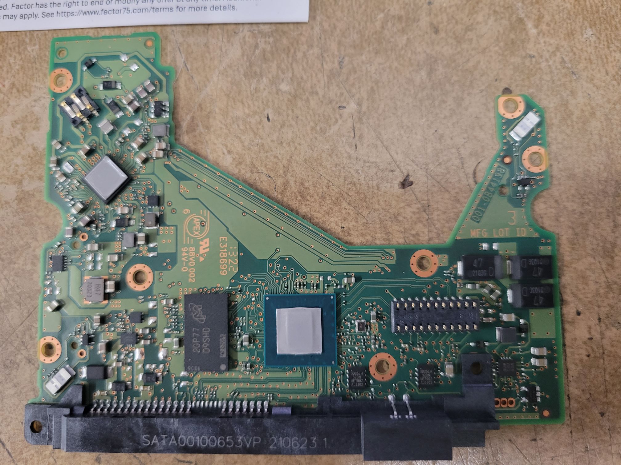

Hello all,
We seek the ROM IC(s) for a WDC WUH721818ALE6L4 HDD. Photo of PCB has been attached
We want to remove them from the patient PCB and solder them back to the Donor PCB.
Thank you,

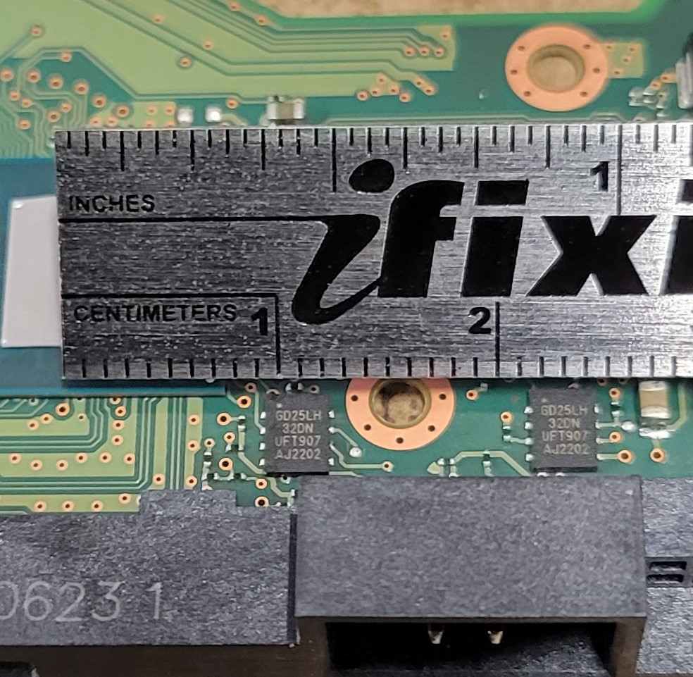

Found that the ROMs are the GD25LH32D ICS Up to the right of the SATA connector
Is there a way to read the ROMs without removing them?
Close up the ROM in the attached Photo
