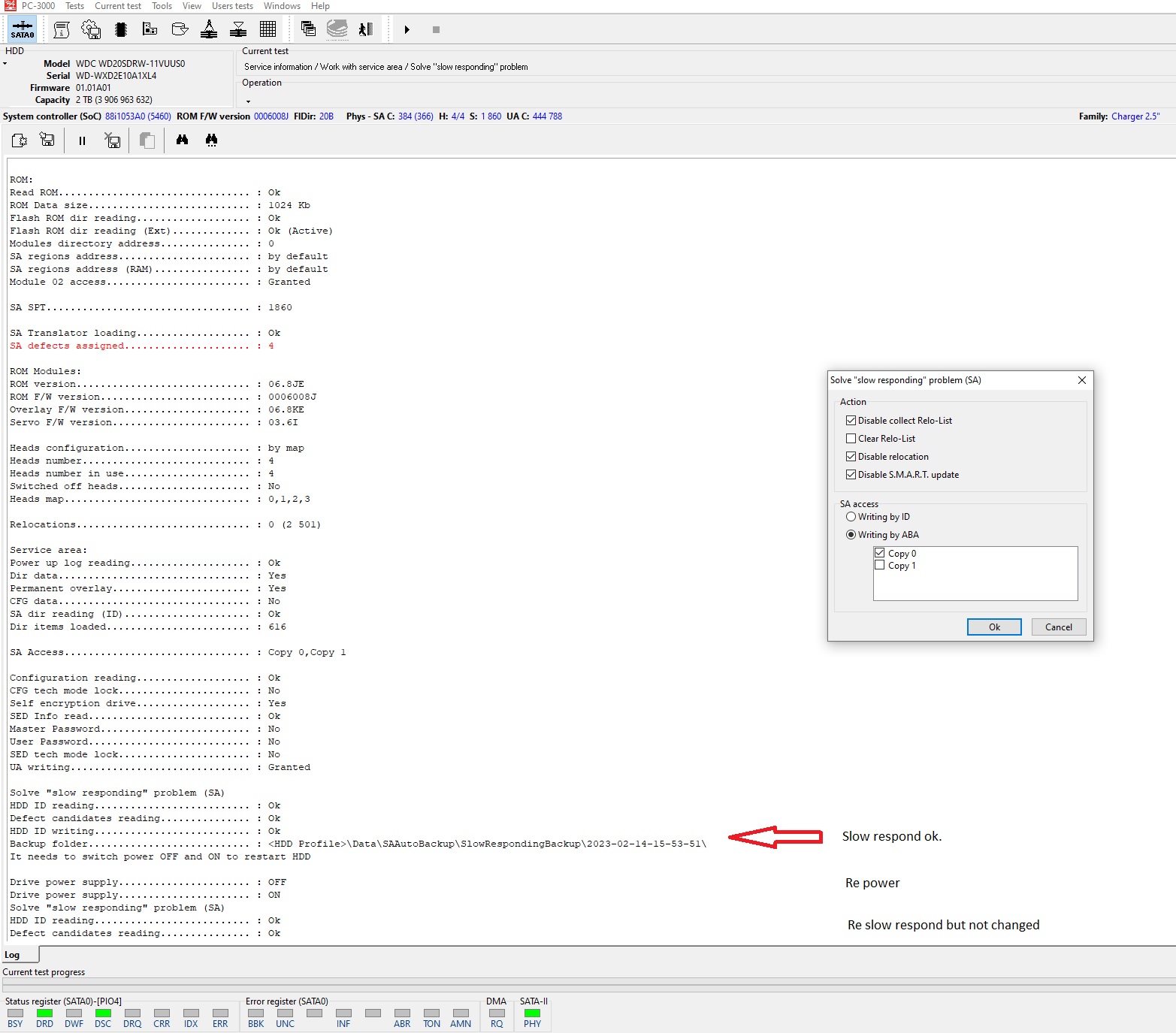

Hello guys!
I have head damaged WD20SDRW-11VUUS0 disk.
Head swap and using SATA PCB all resource file's backuped.
Can't edit and write module. Solve slow resp ok! after power on not changed.
Need help!

Batbold wrote:Hello guys!
Need help!
Its generally not advisable to perform slow responding on SMR drives via the SA.
Can you write it in RAM?

Hello! D_D
Write Slow resp in ram self restarting not changeable. :???:

Re: WD20SDRW can't write module
Postby d_d_recovery » 16.02.23, 15:12
Seems like the new heads may not be compatible.
Or there is some SA media damage.
Do you have LBA access?
