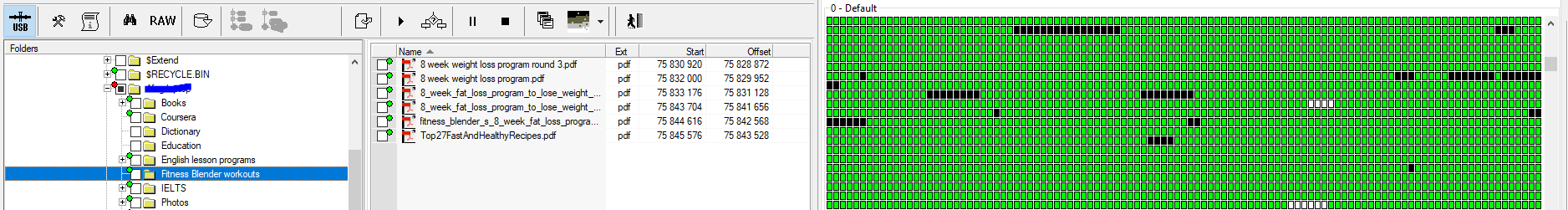

Hi guys please help me .... this is my problem ...mft scan
but others files have size but dont open.... what i can do?

Are you trying to recover a HDD in PC-3000 Flash?

i am traying wd passport with pc-3000 III ssd version .... wd connected to pc-3000 with usb (on board) i have not Unlocking the hard drive

Your drive has bad sectors. At a minimum you need to put a SATA PCB on the drive. Exactly what model is it?
