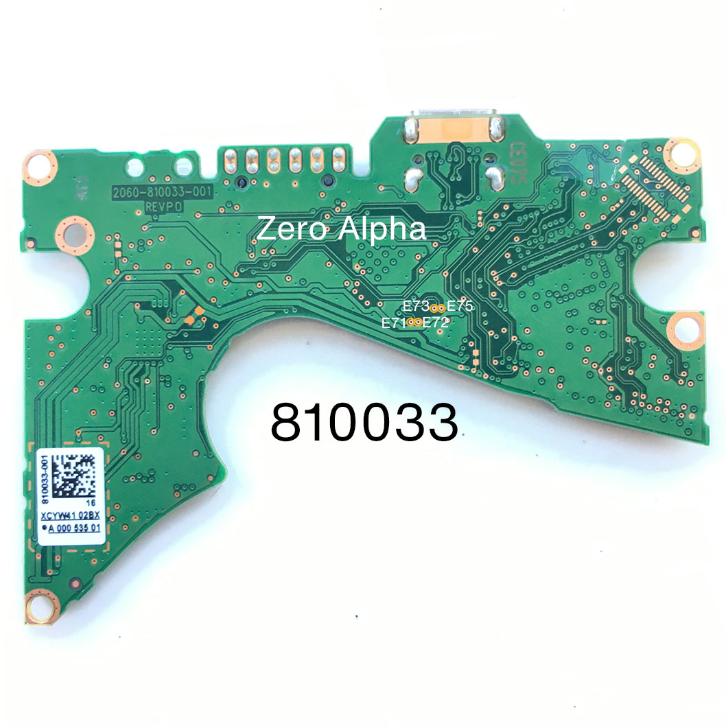

Here is sata pinout for 810033 USB-C board if anybody needs it. This board is also SED locked. Detects as WDC ROM MODEL-SPYG2ULT-

HI
The native USB pcb clicking what may the reason ? with donor USB PCB no clicking , also with unlock PCB Head and modules tested ,everything ok.
