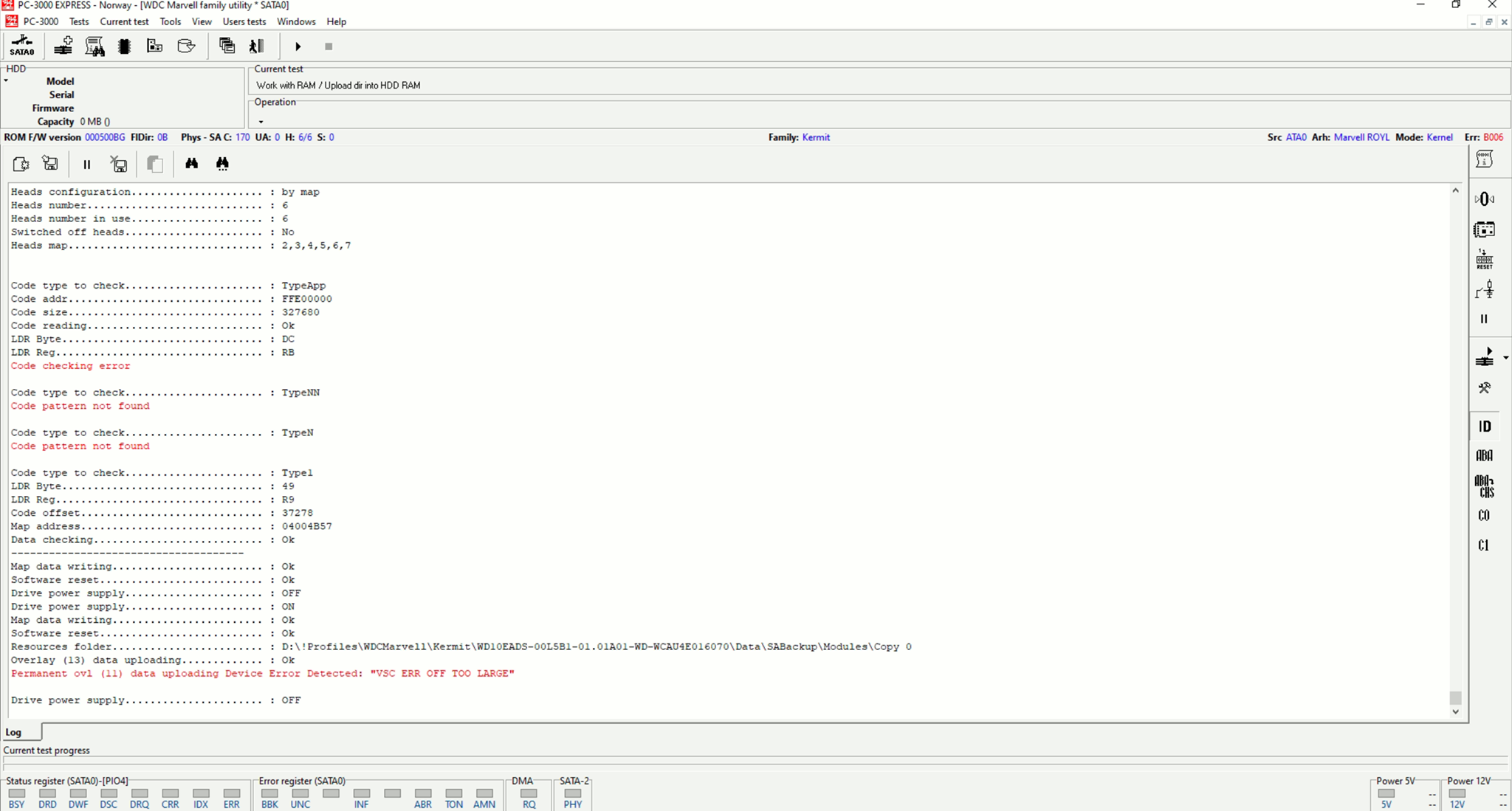

I have a western digital HDD that I am working on now.
I have physically cut head 2 due to a large circular scraper.
But when I try to upload the loader, I get this error (see photos)
Does that mean other heads can be dead too? or something else?
I tried and inspected the heads under a microscope and could not see with my eyes any damage to them
Re: WD10EADS error when uploading loader
Postby AJ2008 » 11.01.21, 13:27
try other loader of same version.
Can you upload dir to ram from SA - maybe native overlay will read OK so you can use native loader.
Other option is hotswap, or use non native ROM and corresponding loader.
What are symptoms you see?
Maxim_TS
Posts: 344
Joined: 27.03.13
Reputation: 18 / (175)
Postby Maxim_TS » 04.02.21, 14:21
Freakazoid wrote:Source of the post Does that mean other heads can be dead too? or something else?
Usually this message means non-compatible donoir overlay. Look for another loaders.
