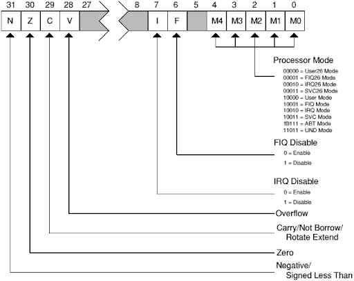

However, it can be also a different series/combination of hex values that turn on or off a particular register..like the attached CPSR...we can see only 1s and 0s...no ABCDEF
However thats purely binary....translation to Hex opcodes will involve all the 16 characters... Right?
I can be wrong, but worth the try to enhance knowledgebase.
