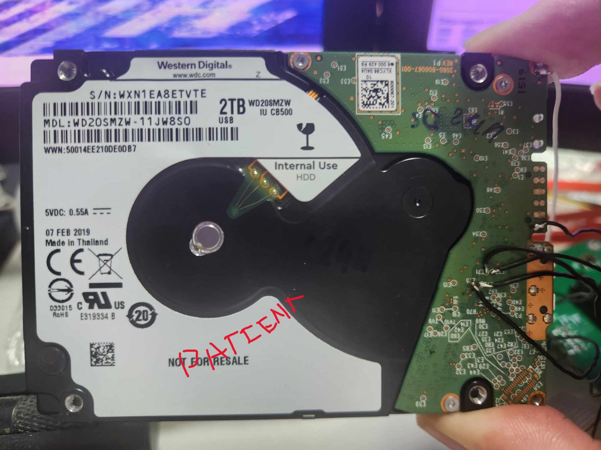

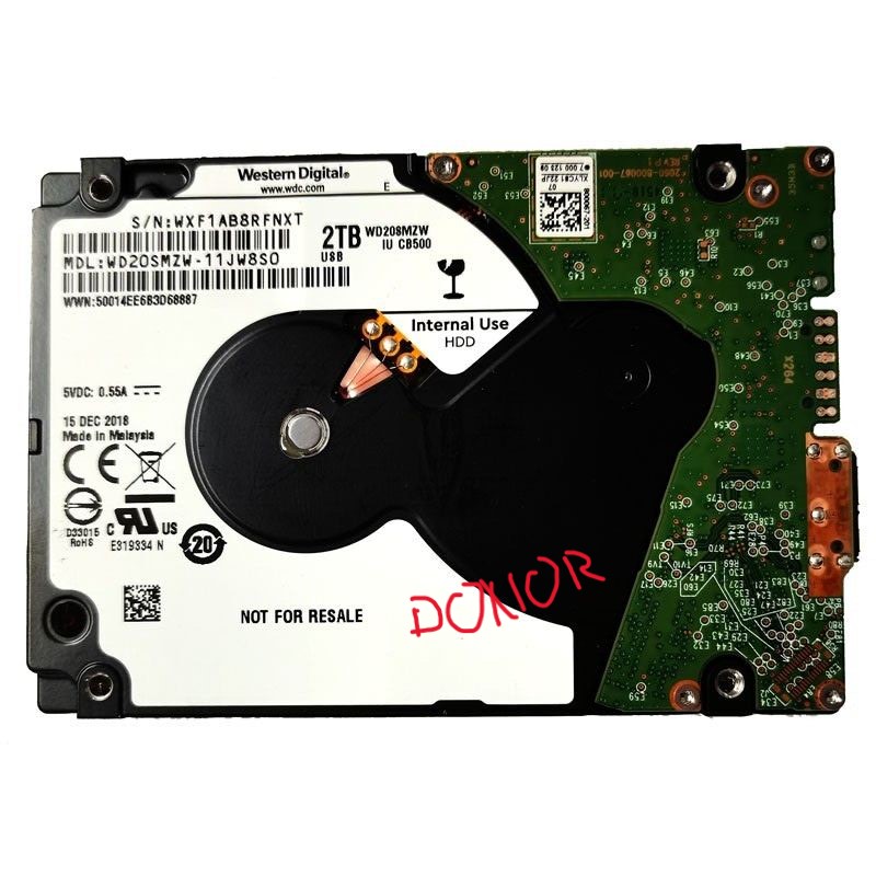

Guys. Sorry. I still need your help guys
So i got the donor. Changed the heads. Unlock ROM vs PC3000, soldered SATA connection. The drives spinning but kept busy without any noise from the heads. I think the heads aren't compatible even though i chose the donor very carefully :oops: :oops: :oops:
I wanted to know the compatibility of these drives. What to look for when buying a donor. And what to look for when changing those heads
Thank You!!!
Here are the pictures of the Patient and the Donor

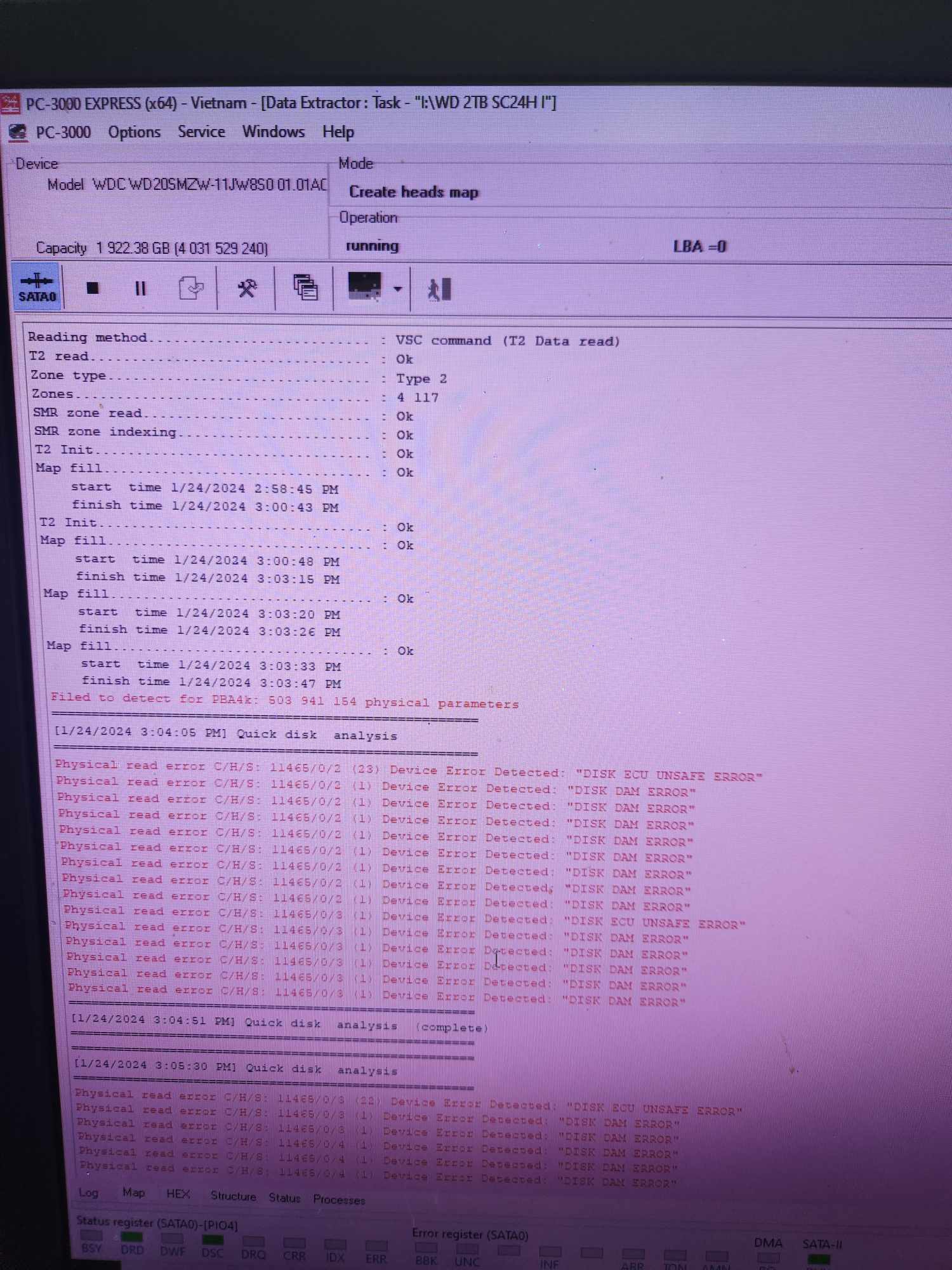

Sorry. Wrong question. So i blocked access in SA upload dir to RAM. Put the drive in Normal mode however all sectors in Sector Edit reads 00 00
Posts: 120
Re: Charger Unlocked PCB encryption issues
Postby gameboybin » 24.01.24, 09:08
digitalsupport wrote:Source of the post What happens when you block access to SA + upload dir and ldr to RAM ?
Nevermind. I managed to make it work. The drive have a lot of Disk Dam Errors
Cannot build head map from this. The LBA=0 keeps getting stuck
Cannot map fill
