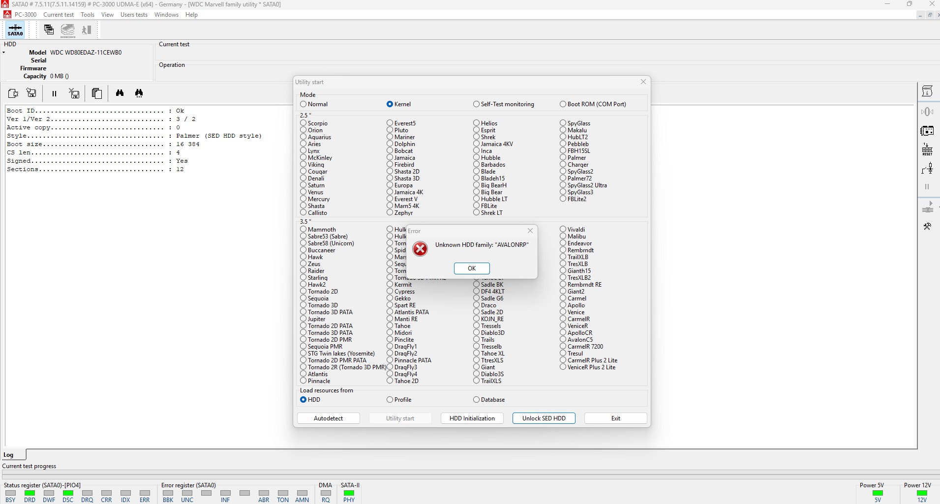

I have the same Problem,
select manualy Venice R gets for me the same result SED Drive Locked
I read out from the firs Chip the ROM, then load it up to PC 3000 utilty (unlock SED HDD) ends up with an Error Unknown HDD family: "AVALONRP"
How to remove the SED Lock?

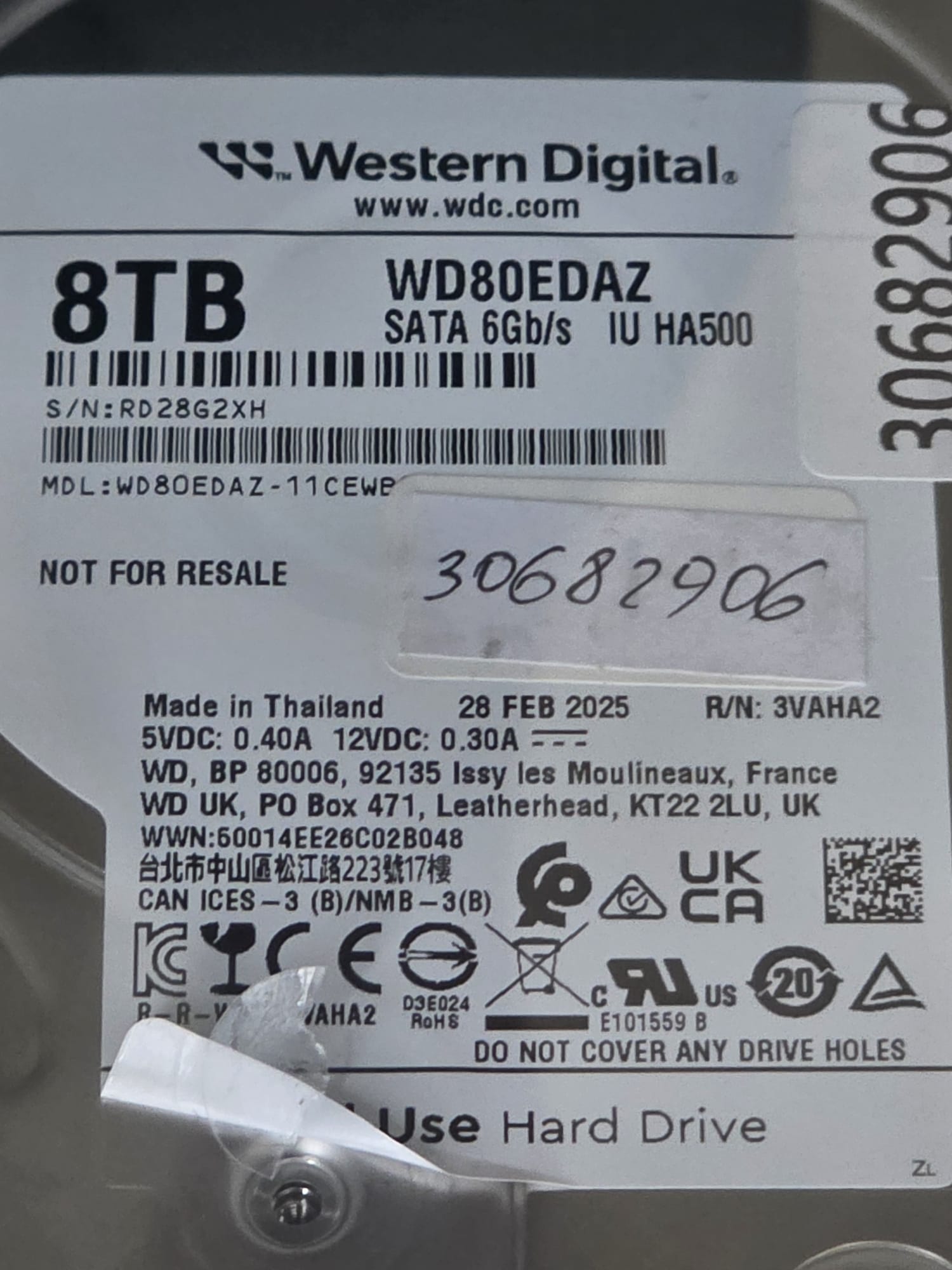

thats the drive and the error
WhatsApp Image 2026-07-01 at 09.48.33.jpeg (226.58 KiB) Viewed 499 times
Screenshot 2026-07-01 114439.jpg (5.06 KiB) Viewed 499 times
