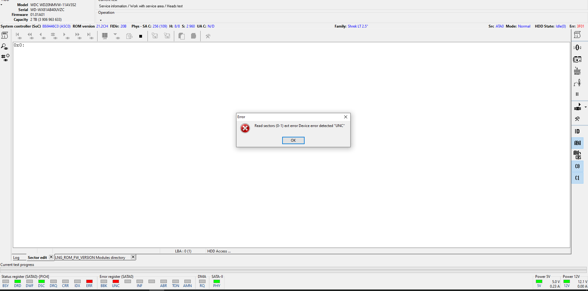

Comes fully ready. No clicking sounds. But cannot access data. i have tested all the heads. backed up all modules. All critical modules seems to be fine but other ones has checksum error and criticical heads error
It shows
Error W: 1480 on every head
So my guess it was the head problem> So i changed the heads with 100% fully functional new donor
It still give me the same exact issues
Cannot access data
Does anyone know the issue?? Can anybody help me out?

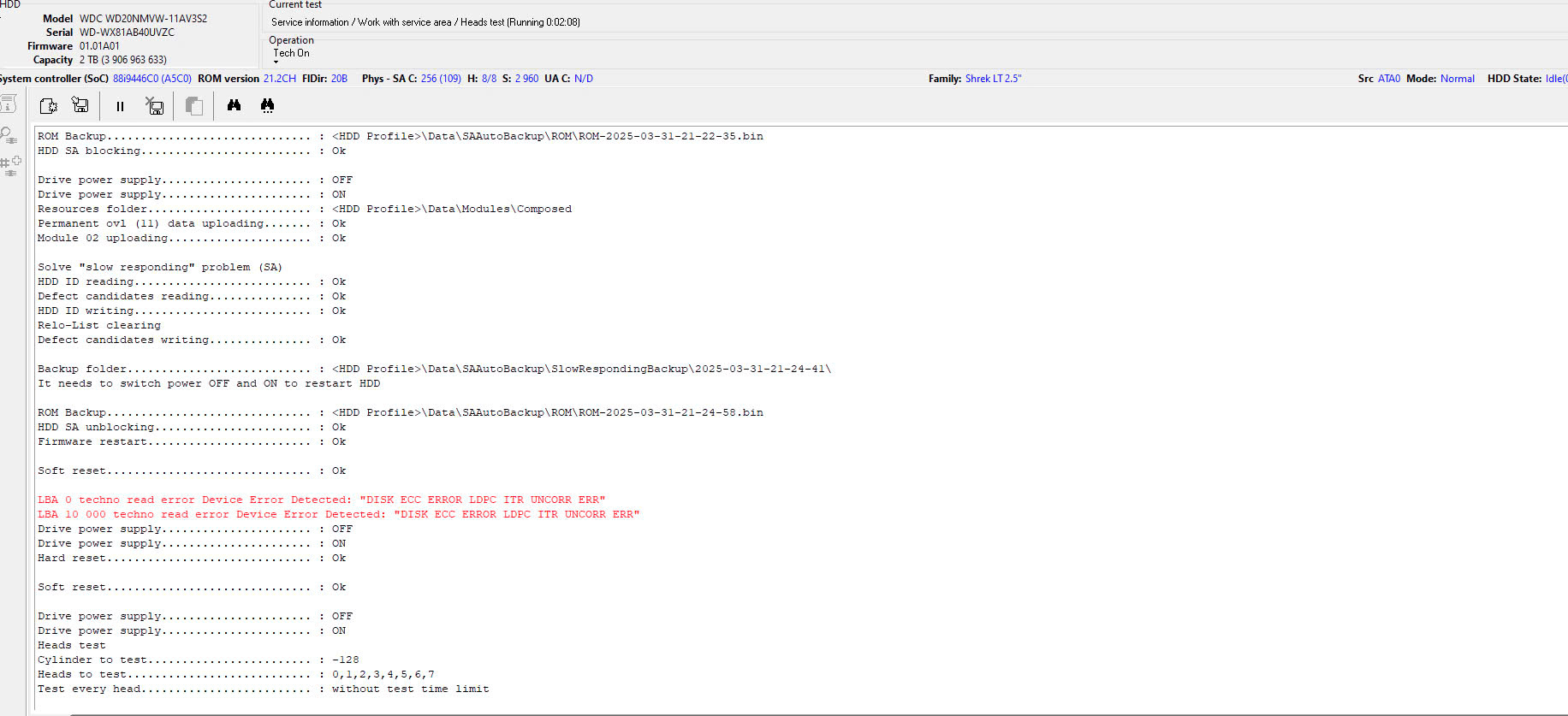

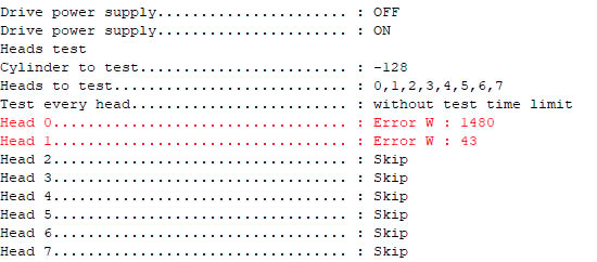

Here are the head test after changing the heads. These errors have been exactly the same before head change
Code: Select all
Heads test
Cylinder to test........................ : -128
Heads to test........................... : 0,1,2,3,4,5,6,7
Test every head......................... : without test time limit
Head 0.................................. : Error W : 1480
Head 1.................................. : Error W : 1480
Head 2.................................. : Skip
Head 3.................................. : Skip
Head 4.................................. : Skip
Head 5.................................. : Skip
Head 6.................................. : Skip
Head 7.................................. : Skip

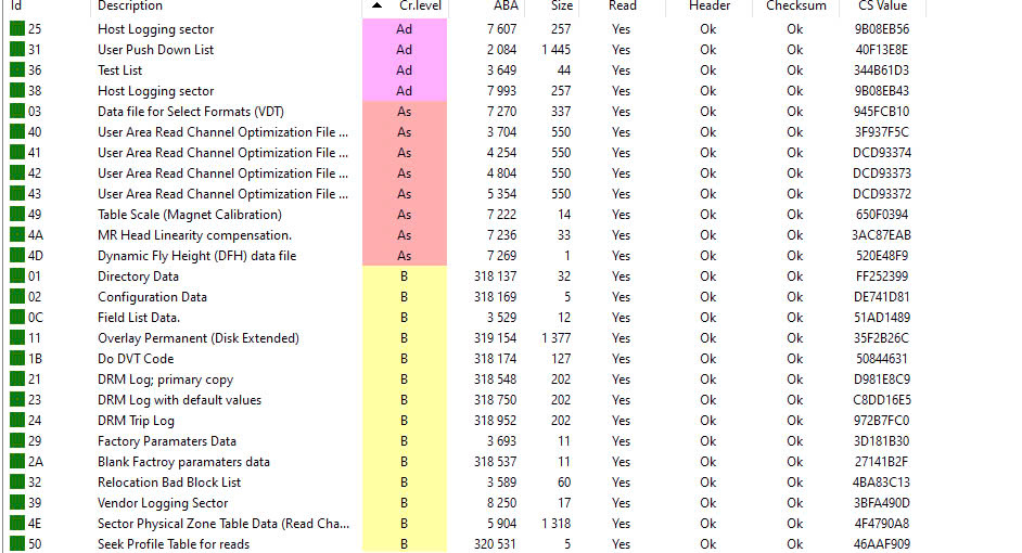

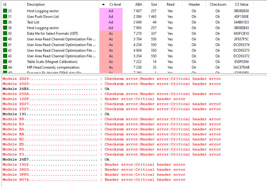

Here are the module checking in SA after swapping fully functional heads
Code: Select all
Modules checking
Module 01............................... : Ok

Module 2D............................... : Header error
Module 2E............................... : Header error
Module 6B............................... : Ok
Module 3A............................... : Ok
Module 28............................... : Ok
Module 3B............................... : Ok
Module 3C............................... : Ok
Module 3D............................... : Ok
Module 3E............................... : Ok
Module 3F............................... : Ok
Module 6F............................... : Ok
Module 16F.............................. : Ok
Module 119.............................. : Ok
Module 68............................... : Ok
Module 69............................... : Ok
Module 6A............................... : Ok
Module 121.............................. : Ok
Module 128.............................. : Ok
Module 12A.............................. : Ok
Module 120.............................. : Ok
Module 12D.............................. : Header error
Module 22D.............................. : Header error
Module 132.............................. : Ok
Module 14A.............................. : Ok
Module 131.............................. : Checksum error;Header error;Critical header error
Module 123.............................. : Ok
Module 124.............................. : Ok
Module 125.............................. : Ok
Module 126.............................. : Ok
Module D002............................. : Ok
Module D003............................. : Ok
Module D004............................. : Ok
Module D005............................. : Ok
Module D000............................. : Ok
Module D001............................. : Ok
Module 127.............................. : Ok
Module D006............................. : Ok
Module 62............................... : Ok
Module 63............................... : Ok
Module 115.............................. : Ok
Module 3700............................. : Checksum error;Header error
Module DE............................... : Checksum error;Header error;Critical header error
Module B6............................... : Checksum error;Header error;Critical header error
Module D5............................... : Checksum error;Header error;Critical header error
Module 34D5............................. : Checksum error;Header error;Critical header error
Module 3426............................. : Checksum error;Header error;Critical header error
Module 3424............................. : Checksum error;Header error;Critical header error
Module 3425............................. : Checksum error;Header error;Critical header error
Module 3431............................. : Checksum error;Header error;Critical header error
Module 3430............................. : Checksum error;Header error;Critical header error
Module 3411............................. : Checksum error;Header error;Critical header error
Module D1............................... : Checksum error;Header error;Critical header error
Module 3513............................. : Checksum error;Header error;Critical header error
Module 34D1............................. : Checksum error;Header error;Critical header error
Module 34D2............................. : Checksum error;Header error;Critical header error
Module 34D3............................. : Checksum error;Header error;Critical header error
Module 34D4............................. : Checksum error;Header error;Critical header error
Module 34D6............................. : Checksum error;Header error;Critical header error
Module 34D8............................. : Checksum error;Header error;Critical header error
Module 34D7............................. : Checksum error;Header error;Critical header error
Module DB............................... : Checksum error;Header error;Critical header error
Module DF............................... : Checksum error;Header error;Critical header error
Module DD............................... : Checksum error;Header error;Critical header error
Module 3514............................. : Checksum error;Header error;Critical header error
Module 3309............................. : Checksum error;Header error;Critical header error
Module 3310............................. : Checksum error;Header error;Critical header error
Module 3311............................. : Checksum error;Header error;Critical header error
Module 3312............................. : Checksum error;Header error;Critical header error
Module 3413............................. : Checksum error;Header error;Critical header error
Module 3414............................. : Checksum error;Header error;Critical header error
Module 3429............................. : Checksum error;Header error;Critical header error
Module 3402............................. : Checksum error;Header error;Critical header error
Module D7............................... : Checksum error;Header error;Critical header error
Module 3300............................. : Checksum error;Header error;Critical header error
Module 3301............................. : Checksum error;Header error;Critical header error
Module 3307............................. : Checksum error;Header error;Critical header error
Module 3303............................. : Checksum error;Header error;Critical header error
Module 3500............................. : Checksum error;Header error;Critical header error
Module BB............................... : Checksum error;Header error;Critical header error
Module 3400............................. : Checksum error;Header error;Critical header error
Module 3407............................. : Checksum error;Header error;Critical header error
Module 3405............................. : Checksum error;Header error;Critical header error
Module D9............................... : Checksum error;Header error;Critical header error
Module D4............................... : Checksum error;Header error;Critical header error
Module 3305............................. : Checksum error;Header error;Critical header error
Module DC............................... : Checksum error;Header error;Critical header error
Module D0............................... : Checksum error;Header error;Critical header error
Module D3............................... : Checksum error;Header error;Critical header error
Module F7............................... : Checksum error;Header error;Critical header error
Module BA............................... : Checksum error;Header error;Critical header error
Module 3406............................. : Checksum error;Header error;Critical header error
Module B9............................... : Checksum error;Header error;Critical header error
Module BC............................... : Checksum error;Header error;Critical header error
Module 3417............................. : Checksum error;Header error;Critical header error
Module D8............................... : Checksum error;Header error;Critical header error
Module BD............................... : Checksum error;Header error;Critical header error
Module BE............................... : Checksum error;Header error;Critical header error
Module 3401............................. : Checksum error;Header error;Critical header error
Module 3302............................. : Checksum error;Header error;Critical header error
Module 3304............................. : Checksum error;Header error;Critical header error
Module 3501............................. : Checksum error;Header error;Critical header error
Module 3502............................. : Checksum error;Header error;Critical header error
Module 3416............................. : Checksum error;Header error;Critical header error
Module 3F01............................. : Header error;Critical header error
Module B8............................... : Header error;Critical header error
Module BF............................... : Header error;Critical header error
Module 34E7............................. : Header error;Critical header error
Module 3802............................. : Header error;Critical header error
Module B7............................... : Ok
Module FA............................... : Ok
Module FC............................... : Ok
Module FD............................... : Ok
Module EE............................... : Ok
Module 3E00............................. : Ok
Module 3801............................. : Checksum error;Header error;Critical header error
Module 3C00............................. : Ok
Module 3423............................. : Checksum error;Header error;Critical header error
Module 3422............................. : Checksum error;Header error;Critical header error
Module 3511............................. : Checksum error;Header error;Critical header error
Module 3421............................. : Checksum error;Header error;Critical header error
Module 3503............................. : Checksum error;Header error;Critical header error
Module 3F00............................. : Checksum error;Header error;Critical header error
Module 3504............................. : Checksum error;Header error;Critical header error
Module 3408............................. : Checksum error;Header error;Critical header error
Module 3605............................. : Checksum error;Header error;Critical header error
Module 3551............................. : Checksum error;Header error;Critical header error
Module 3703............................. : Checksum error;Header error;Critical header error
Module E7............................... : Ok
Module C5............................... : Checksum error;Header error;Critical header error
Module 2401............................. : Checksum error;Header error;Critical header error
Module 2403............................. : Checksum error;Header error;Critical header error
Module 2404............................. : Checksum error;Header error;Critical header error
Module 2420............................. : Checksum error;Header error;Critical header error
Module 2407............................. : Checksum error;Header error;Critical header error
Module 2408............................. : Checksum error;Header error;Critical header error
Module 2409............................. : Checksum error;Header error;Critical header error
Module 2410............................. : Checksum error;Header error;Critical header error
Module 2428............................. : Checksum error;Header error;Critical header error
Module 242F............................. : Checksum error;Header error;Critical header error
Module 240C............................. : Checksum error;Header error;Critical header error
Module 241E............................. : Checksum error;Header error;Critical header error
Module 241F............................. : Checksum error;Header error;Critical header error
Module 2414............................. : Checksum error;Header error;Critical header error
Module 240B............................. : Checksum error;Header error;Critical header error
Module 2413............................. : Checksum error;Header error;Critical header error
Module 240A............................. : Checksum error;Header error;Critical header error
Module 241D............................. : Checksum error;Header error;Critical header error
Module 240E............................. : Checksum error;Header error;Critical header error
Module 2422............................. : Checksum error;Header error;Critical header error
Module 2427............................. : Checksum error;Header error;Critical header error
Module 2423............................. : Checksum error;Header error;Critical header error
Module 2415............................. : Checksum error;Header error;Critical header error
Module 2424............................. : Checksum error;Header error;Critical header error
Module 241A............................. : Checksum error;Header error;Critical header error
Module 2429............................. : Checksum error;Header error;Critical header error
Module 242A............................. : Checksum error;Header error;Critical header error
Module 242C............................. : Checksum error;Header error;Critical header error
Module 242B............................. : Checksum error;Header error;Critical header error
Module 242D............................. : Checksum error;Header error;Critical header error
Module 2425............................. : Checksum error;Header error;Critical header error
Module 242E............................. : Checksum error;Header error;Critical header error
Module 2433............................. : Checksum error;Header error;Critical header error
Module 2432............................. : Checksum error;Header error;Critical header error
Module 8010............................. : Checksum error;Header error;Critical header error
Module 802C............................. : Header error;Critical header error
Module 8035............................. : Header error;Critical header error
Module 8038............................. : Checksum error;Header error;Critical header error
Module 803C............................. : Checksum error;Header error;Critical header error
Module 8016............................. : Checksum error;Header error;Critical header error
Module 801D............................. : Checksum error;Header error;Critical header error
Module 8044............................. : Header error;Critical header error
Module 8031............................. : Header error;Critical header error
Module 8062............................. : Header error;Critical header error
Module 8063............................. : Header error;Critical header error
Module 8041............................. : Critical header error
Module 8042............................. : Critical header error
Module 800E............................. : Checksum error;Header error;Critical header error
Module 802D............................. : Checksum error;Header error;Critical header error
Module 8019............................. : Checksum error;Header error;Critical header error
Module 802F............................. : Checksum error;Header error;Critical header error
Module 8034............................. : Checksum error;Header error;Critical header error
Module 802E............................. : Checksum error;Header error;Critical header error
Module 8032............................. : Checksum error;Header error;Critical header error
Module 8017............................. : Checksum error;Header error;Critical header error
Module 8002............................. : Checksum error;Header error;Critical header error
Module 800B............................. : Checksum error;Header error;Critical header error
Module 8005............................. : Checksum error;Header error;Critical header error
Module 8020............................. : Checksum error;Header error;Critical header error
Module 8046............................. : Checksum error;Header error;Critical header error
Module 8045............................. : Checksum error;Header error;Critical header error
Module 8027............................. : Checksum error;Header error;Critical header error
Module 8014............................. : Checksum error;Header error;Critical header error
Module 801C............................. : Checksum error;Header error;Critical header error
Module 8023............................. : Checksum error;Header error;Critical header error
Module 801F............................. : Checksum error;Header error;Critical header error
Module 803A............................. : Checksum error;Header error;Critical header error
Module 803E............................. : Checksum error;Header error;Critical header error
Module 8012............................. : Checksum error;Header error;Critical header error
Module 8026............................. : Checksum error;Header error;Critical header error
Module 802B............................. : Header error;Critical header error
Module 8029............................. : Header error;Critical header error
Module 802A............................. : Header error;Critical header error
Module 8037............................. : Header error;Critical header error
Module 803B............................. : Header error;Critical header error
Module 800F............................. : Header error;Critical header error
Module 800A............................. : Header error;Critical header error
Module 8025............................. : Header error;Critical header error
Module 8009............................. : Header error;Critical header error
Module 800C............................. : Header error;Critical header error
Module 8006............................. : Header error;Critical header error
Module 8018............................. : Header error;Critical header error
Module 800D............................. : Header error;Critical header error
Module 8008............................. : Header error;Critical header error
Module 8024............................. : Header error;Critical header error
Module 8015............................. : Header error;Critical header error
Module 8007............................. : Header error;Critical header error
Module 8065............................. : Header error;Critical header error
Module 801A............................. : Header error;Critical header error
Module 8030............................. : Header error;Critical header error
Module 801E............................. : Checksum error;Header error;Critical header error
Module 8001............................. : Header error;Critical header error
Module 8022............................. : Header error;Critical header error
Module 8064............................. : Header error;Critical header error
Module 8049............................. : Header error;Critical header error
Module 805D............................. : Checksum error;Header error;Critical header error
Module 805E............................. : Checksum error;Header error;Critical header error
Module 805F............................. : Header error;Critical header error

Module 1814............................. : Checksum error;Header error;Critical header error
Module 66............................... : Checksum error;Header error;Critical header error
Module ADDD............................. : Checksum error;Header error;Critical header error
Module FE............................... : Header error;Critical header error
Module 2D22............................. : Checksum error;Header error;Critical header error
Module 252A............................. : Checksum error;Header error;Critical header error
Module 3C10............................. : Header error;Critical header error
Module 3C20............................. : Checksum error;Header error;Critical header error
Module 3C11............................. : Header error;Critical header error
Module 3C21............................. : Checksum error;Header error;Critical header error
Module 3C12............................. : Header error;Critical header error
Module 3C22............................. : Checksum error;Header error;Critical header error
Module 3C13............................. : Header error;Critical header error
Module 3C23............................. : Checksum error;Header error;Critical header error
Module 3C14............................. : Checksum error;Header error;Critical header error
Module 3C24............................. : Checksum error;Header error;Critical header error
Module 3C15............................. : Header error;Critical header error
Module 3C25............................. : Checksum error;Header error;Critical header error
Module 3C16............................. : Checksum error;Header error;Critical header error
Module 3C26............................. : Checksum error;Header error;Critical header error
Module 3C17............................. : Header error;Critical header error
Module 3C27............................. : Header error;Critical header error
Module 3E01............................. : Header error;Critical header error
Module 3F04............................. : Header error;Critical header error
Module 3F03............................. : Header error;Critical header error
Module 1410............................. : Header error;Critical header error
Module 2D0A............................. : Checksum error;Header error;Critical header error
Module 250B............................. : Checksum error;Header error;Critical header error
Module 26E3............................. : Ok
Module 26E4............................. : Ok
Module 26E5............................. : Ok
Module 252D............................. : Checksum error;Header error;Critical header error
Module 2D0E............................. : Checksum error;Header error;Critical header error
Module 250E............................. : Checksum error;Header error;Critical header error
Module 2D1F............................. : Checksum error;Header error;Critical header error
Module 251F............................. : Checksum error;Header error;Critical header error
Module 1400............................. : Header error;Critical header error
Module 2522............................. : Checksum error;Header error;Critical header error
Module 2D29............................. : Checksum error;Header error;Critical header error
Module 2529............................. : Checksum error;Header error;Critical header error
Module 26E6............................. : Ok
Module 250A............................. : Checksum error;Header error;Critical header error
Module 120F............................. : Header error;Critical header error
Module 2D27............................. : Checksum error;Header error;Critical header error
Module 2527............................. : Checksum error;Header error;Critical header error
Module 191.............................. : Ok
Module E8............................... : Checksum error;Header error;Critical header error
Module E9............................... : Checksum error;Header error;Critical header error
Module EA............................... : Checksum error;Header error;Critical header error
Module EB............................... : Checksum error;Header error;Critical header error
Module EC............................... : Checksum error;Header error;Critical header error
Module ED............................... : Checksum error;Header error;Critical header error
Module F2............................... : Checksum error;Header error;Critical header error
Module F3............................... : Checksum error;Header error;Critical header error
Module 26E7............................. : Ok
Module 1902............................. : Header error;Critical header error
Module 3803............................. : Header error;Critical header error
Module 3FF0............................. : Header error;Critical header error
Module 8074............................. : Header error;Critical header error
Screenshot 2025-03-31 215239.png (8.11 KiB) Viewed 3187 times
