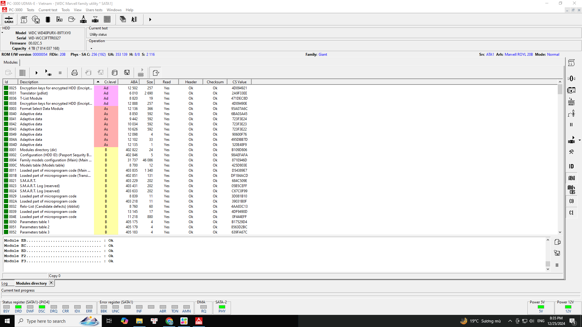

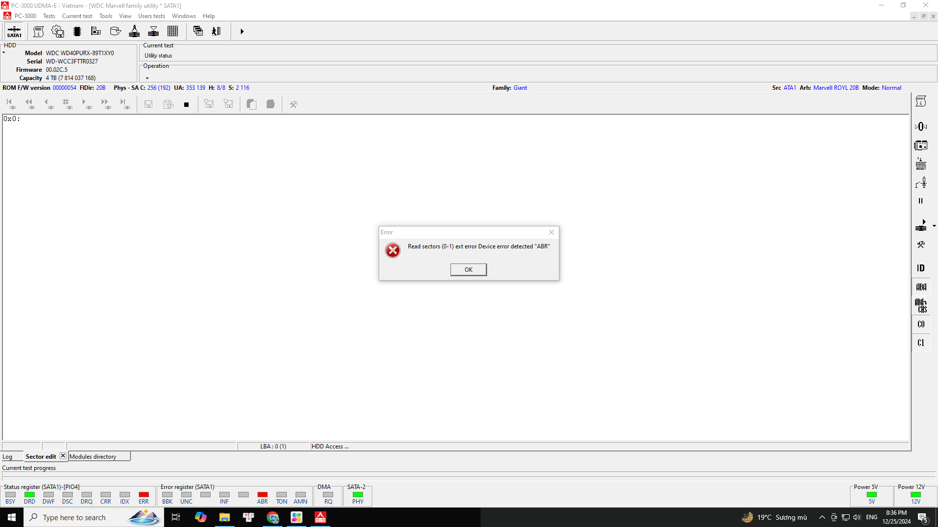

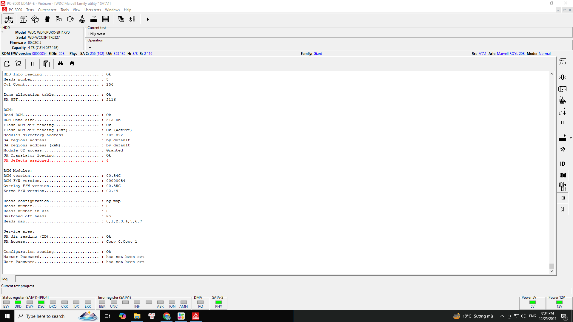

Hi everyone. I need some help with this drive
4TB Purple WD40PURX. Got full ID and modules. However cannot read the data! Device error detected: ABR
Many Thanks!

148 cache module
