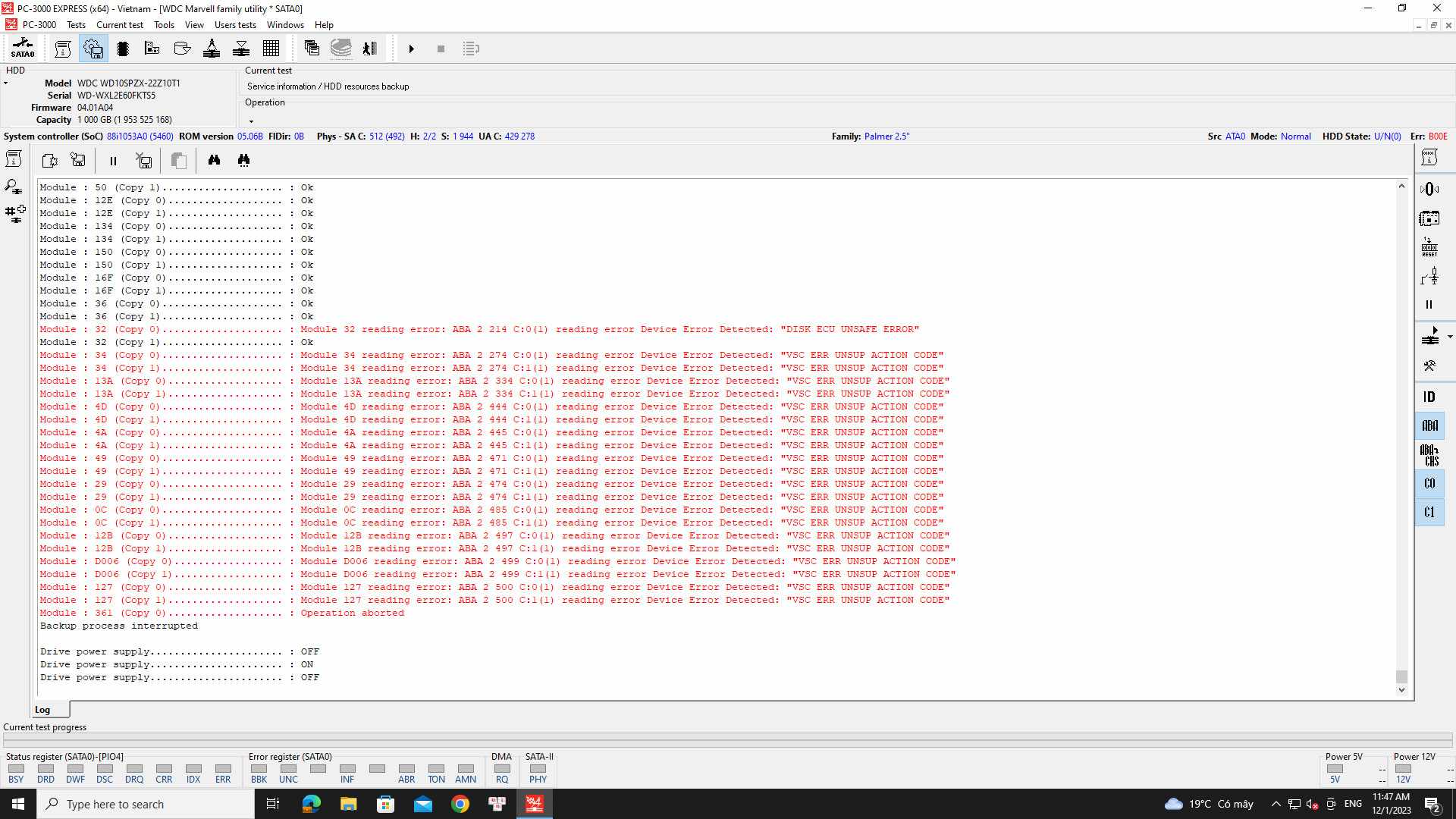

When it first come to me it has Head issue. The drive spins up but makes Head clicking sound
I proceed to change it heads
and unlock SED of the Drive

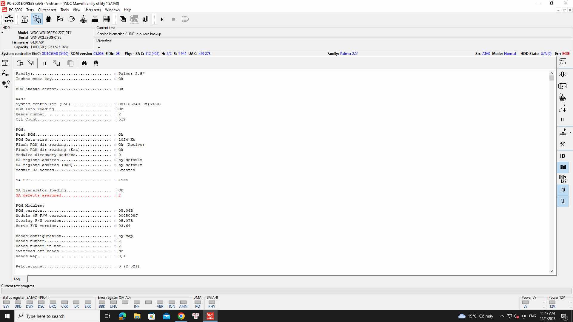

Everything was fine. Plugged to PC3000 Readied, ID normally
As soon as i clicked HDD Resource Backup
The heads starts clicking and the HDD dies. 5V goes from 0.87 to 0.17
Drive stops spinning and since that never comes alive again
I tested 1 more time with another pair of heads. Same issue. Drive straight up dies upon backing up
Tried swapping back to test those donor drives. They all became dead with 5V 0.17
I checked platters of the customers drive. All clean and well. I guess this customers drive is somehow a Drive killer
Would love to hear other opinions
Or someone that can shed light upon this!!!
