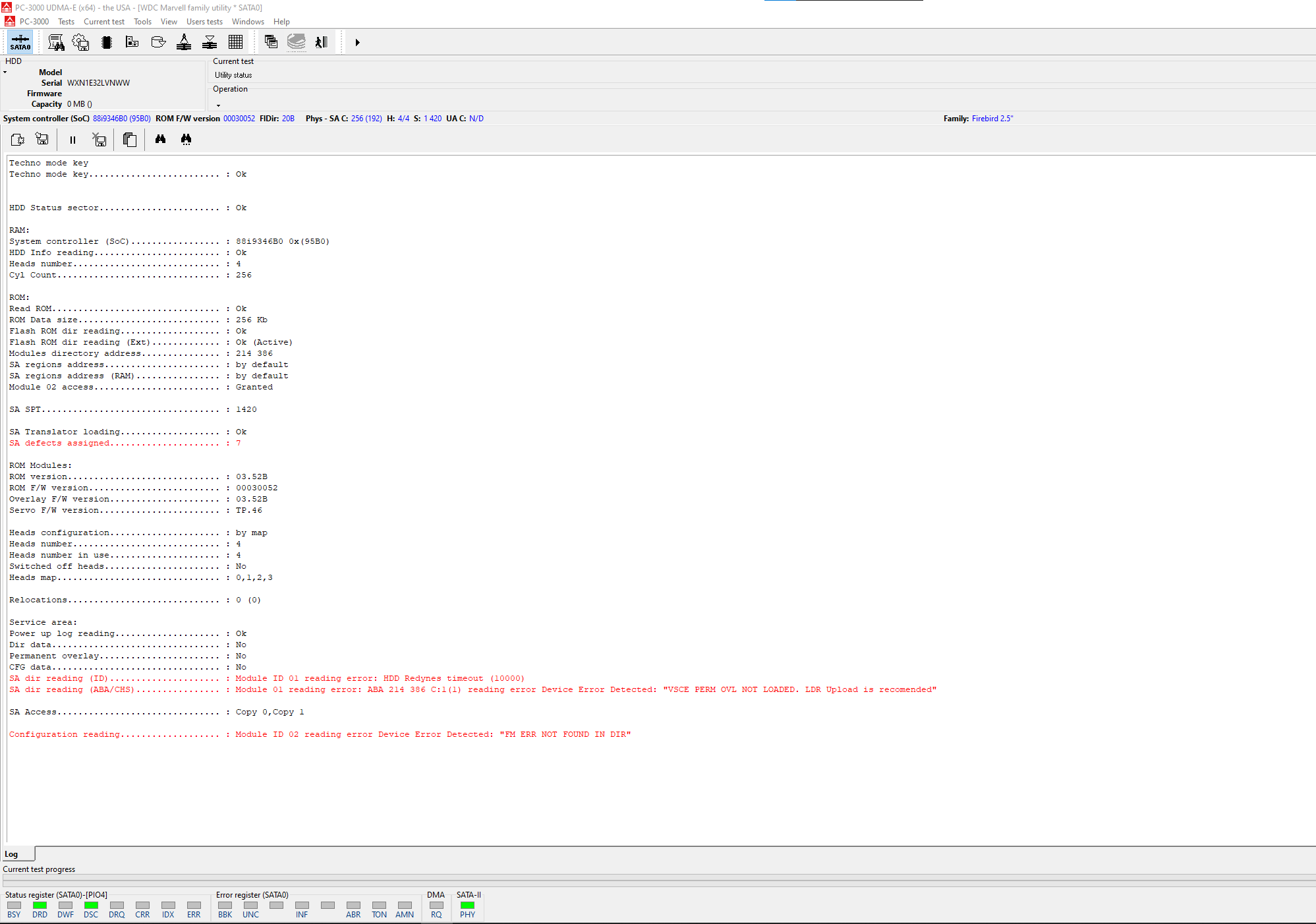

Hello everybody. I have here a 1TB WD. Heads replaced but have SA defects and No Dir data, Permanent overlay or CFG data, Module ID 1 error and Module ID 02 error.
I am still learning but from my understanding I have to upload Dir and LDR correct? I checked for the firmware but do not see a file I can upload and don't want to move forward to risk an unsuccessful recovery.
Model is blank
Serial is correct
FW blank
Capacity 0MB
Please see photo attached. TIA for any help.
Techno mode key
RAM:
System controller (SoC)................. : 88i9346B0 0x(95B0)
Cyl Count............................... : 256
ROM:
ROM Data size........................... : 256 Kb
Modules directory address............... : 214 386
SA SPT.................................. : 1420
SA defects assigned..................... : 7
ROM Modules:
ROM version............................. : 03.52B
ROM F/W version......................... : 00030052
Overlay F/W version..................... : 03.52B
Servo F/W version....................... : TP.46
Heads number in use..................... : 4
Heads map............................... : 0,1,2,3
Service area:
Dir data................................ : No
Permanent overlay....................... : No
CFG data................................ : No
SA dir reading (ID)..................... : Module ID 01 reading error: HDD Redynes timeout (10000)
SA dir reading (ABA/CHS)................ : Module 01 reading error: ABA 214 386 C:1(1) reading error Device Error Detected: "VSCE PERM OVL NOT LOADED. LDR Upload is recomended"
Configuration reading................... : Module ID 02 reading error Device Error Detected: "FM ERR NOT FOUND IN DIR"
