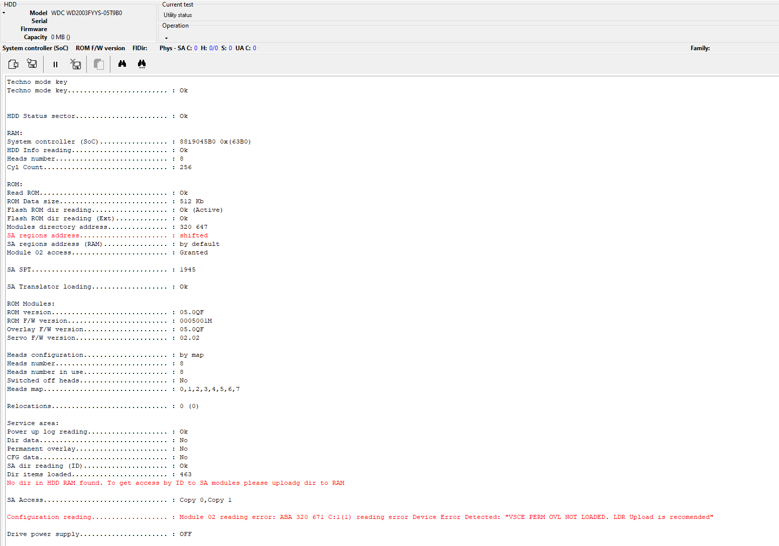

Hello all, I have a 2TB WD here that a TA helped me with. I have to change back SA regions address since its shifted. NO Dir in HDD Ram, a module 02 error with LDR uploaded recommended. I'm still new to this but thought I would post to see if anyone can walk me through it. Thank you.
At first the drive was stuck in BSY state with no device ID. Changed heads with working donor and drive becomes ready.
Techno mode key
RAM:
System controller (SoC)................. : 88i9045B0 0x(63B0)
Heads number............................ : 8
Cyl Count............................... : 256
ROM:
ROM Data size........................... : 512 Kb
Flash ROM dir reading................... : Ok (Active)
Flash ROM dir reading (Ext)............. : Ok
Modules directory address............... : 320 647
SA regions address...................... : shifted
SA SPT.................................. : 1945
ROM Modules:
ROM version............................. : 05.0QF
ROM F/W version......................... : 0005001M
Overlay F/W version..................... : 05.0QF
Servo F/W version....................... : 02.02
Heads number in use..................... : 8
Heads map............................... : 0,1,2,3,4,5,6,7
Service area:
Dir data................................ : No
Permanent overlay....................... : No
CFG data................................ : No
Dir items loaded........................ : 463
No dir in HDD RAM found. To get access by ID to SA modules please uploadg dir to RAM
Configuration reading................... : Module 02 reading error: ABA 320 671 C:1(1) reading error Device Error Detected: "VSCE PERM OVL NOT LOADED. LDR Upload is recomended"
Drive power supply...................... : OFF
Screenshot 2023-02-18 122822.png (11.45 KiB) Viewed 8434 times

If SA is shifted, then it's normal not to have access to SA :)
If you want to get back SA access, you need to change the SA location back to its original value.
PC3000 does this automatically from here: Work with ROM>Allow SA Access and Restart HDD
