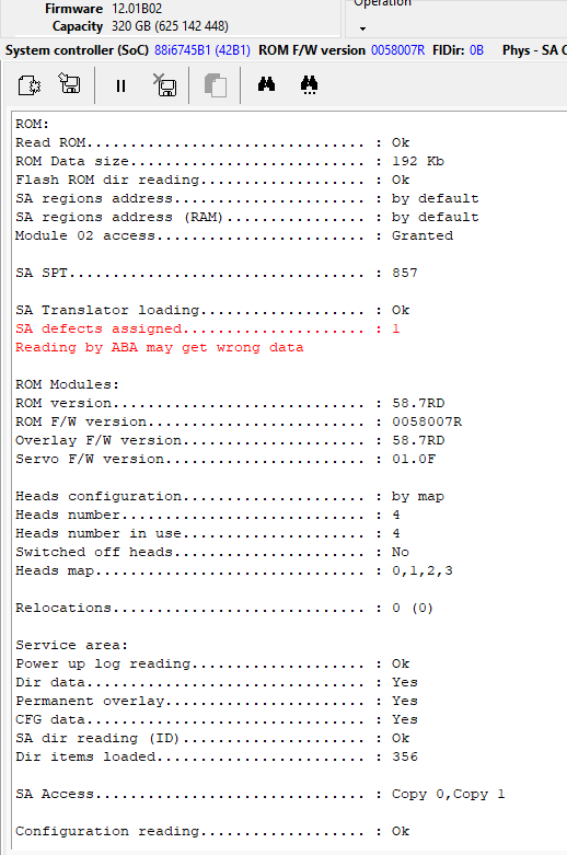

WD3200AAJS-65VWA0 Tornado 2D drive detecting all modules backed up and but data looks like not correct. I get error in utility " SA defects assigned..................... : 1
Reading by ABA may get wrong data " Picture attached, Any idea how to fix ?
Screenshot (155).png (105.37 KiB) Viewed 4907 times

Not much information to go on there.
Can you read sectors?
If so, are the sector encrypted?
Is it a USB PCB or SATA?
Has it has a head swap?

Drive has no encryption, I can read sectors and data looks like garbage.

firdousnet wrote:Source of the post Hi
Sounds like encryption to me.
