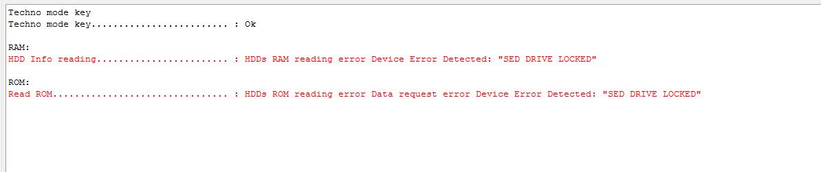

i have isolate pcb tried PebbleB then i got SED drive locked may be PC3000 not support this model & family .

CS DATA RECOVERY wrote:Source of the post then i got SED drive locked may be PC3000 not support
you are right, such drives are SED locked in ROM and have a lot of another different issues. They are not supported in PC-3000 for now.
Re: WDC WD10SDZW-11UMGS0 WHICH FAMILY
It's a Palmer drive (other Palmer drives Y0TS, Z10T, UMGS, EW0T)
Palmer drives are locked differently comparing to previous SED families.
Palmer drives are not supported by PC3K(including unlocking procedure), but you can outsource such drives to people who can do them.

ROM:
Read ROM................................ : HDDs ROM reading error Data request error Device Error Detected: "SED DRIVE LOCKED"

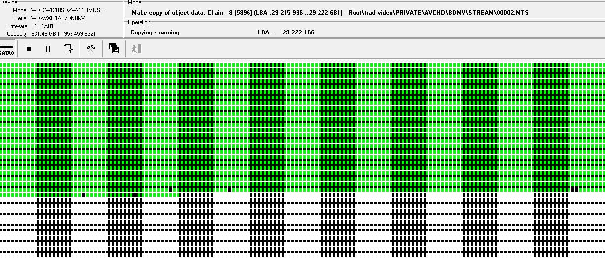

Working with a Palmer.
Can READ SA. But cant HEAD MAP
TRIED TO IMAGE, MOST DATA AREA SAYS UNREADABLE, REST AREA READS SMOOTH.
Whats your experienc?
shahi wrote:Source of the post But cant HEAD MAP
Head map editing in RAM and head map building in Data Extractor are not possible for these new drives due to new LBA-CHS conversion.
ACELab developers are woring on it.

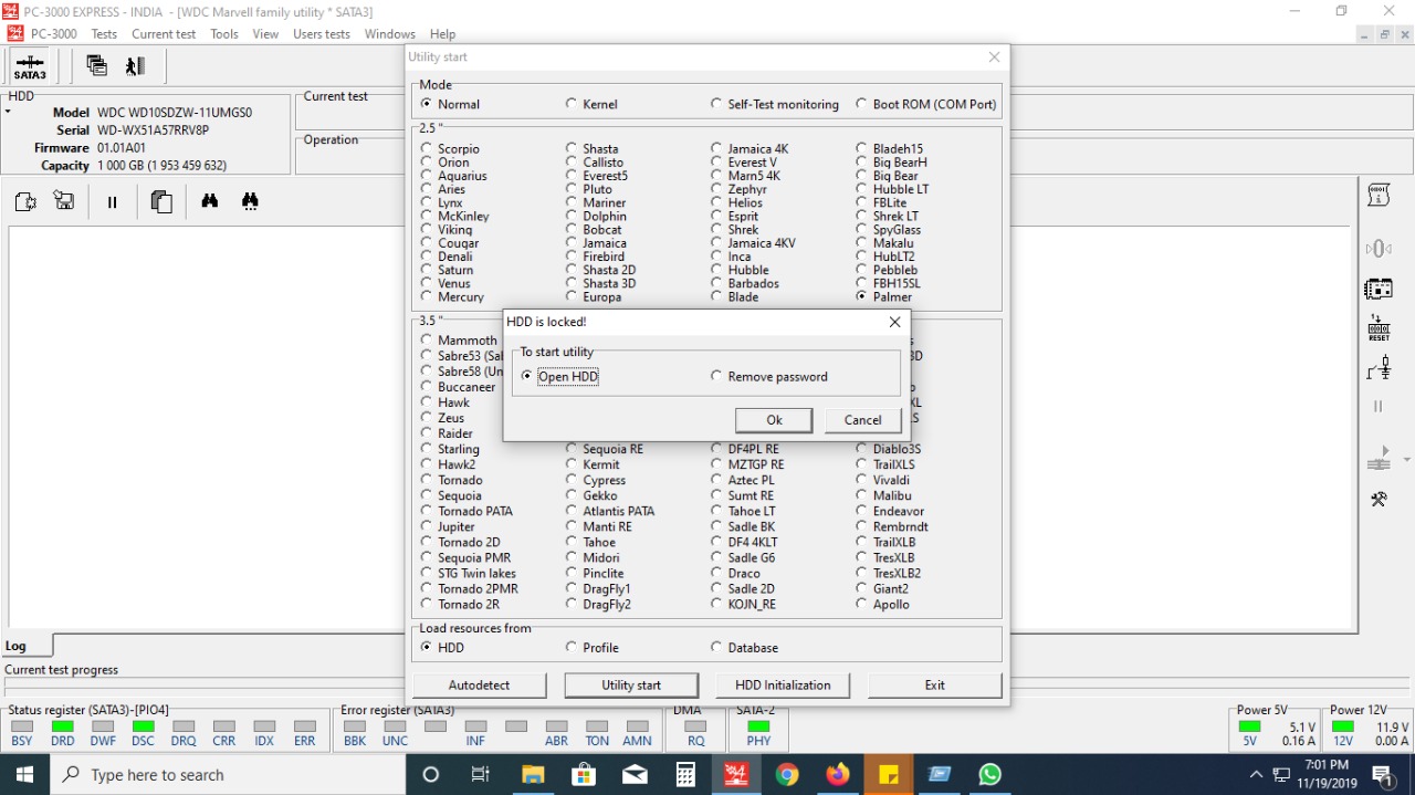

PASSWORD RECOVERY POSSIBLES ?
