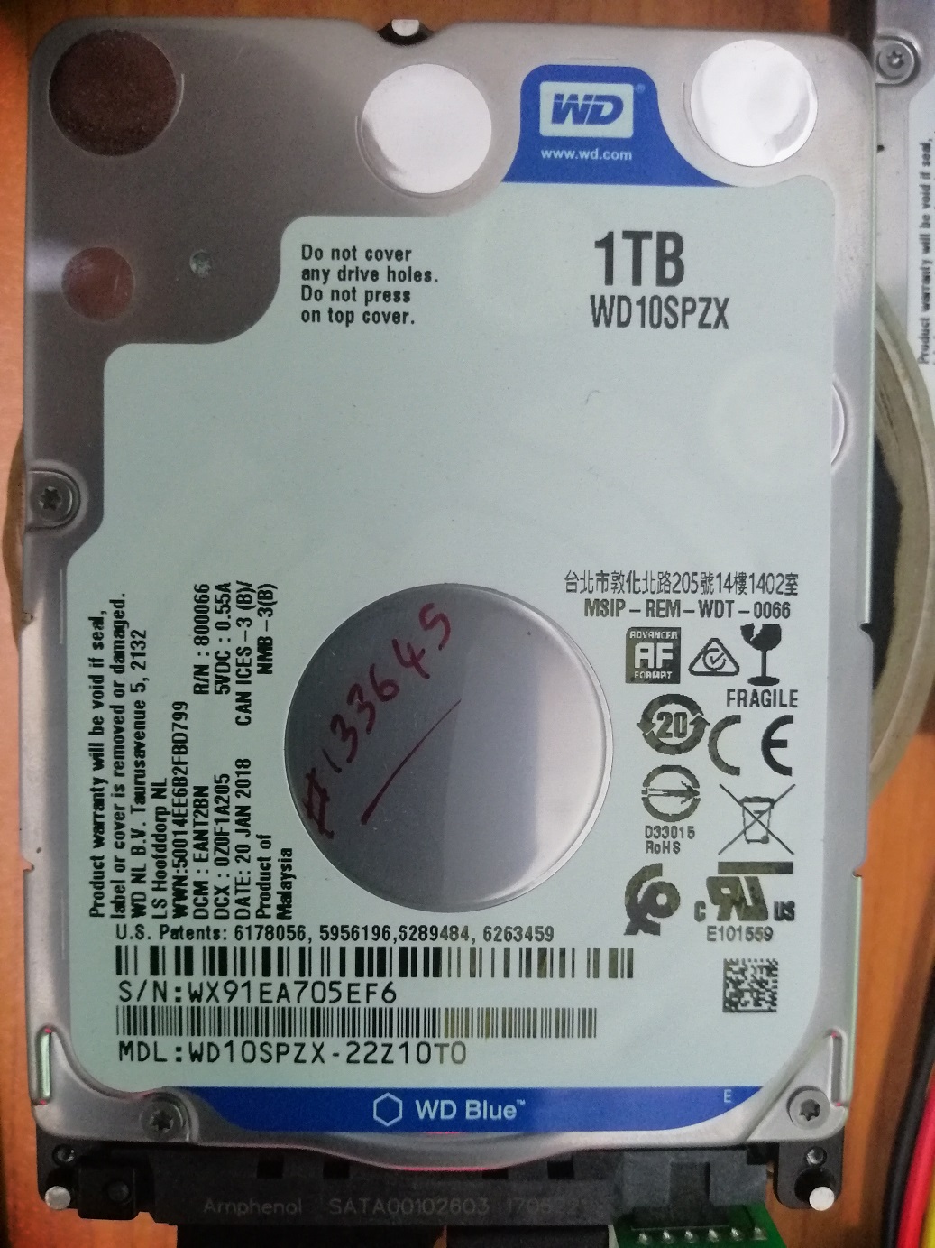

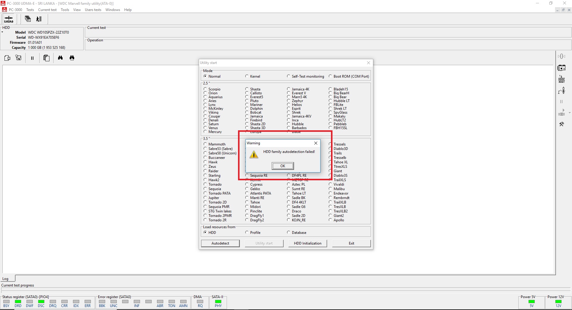

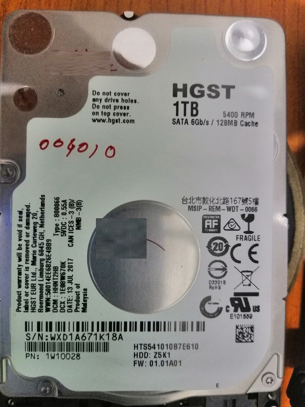

Hello, My Friends,,
please check attached pictures.
Why This Both Hard disk not support with pc3k ??
both hard disk have WD PCB ( 2060-800066-004),
HDD Vendor & Utilities Auto select WD Marvell, but Supported family not detect.
both hard disk have slow responding busy error,
please help to me solve this case.

Postby GuideRecovery » 06.12.18, 16:28
Its Palmer family drive, not supported by pc3000 so far.
try imaging drive directly without doing anything if you can, these drives have very strange behavior when it comes to head problem, Heads will read fine where there is no data stored, where data is on sector it gives problem. if this is the case, you need to change heads.
