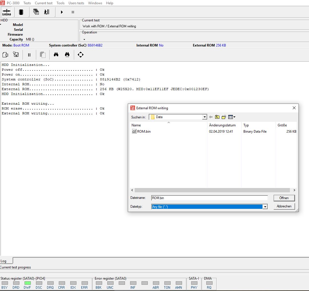

Hi Amarbir,
hi Maxim,
so i will block the access but i can´t do it...
look at the picture, i haven´t the checkbox....?!?
Why?
hi Maxim,
Why?
Re: WD5000BPVT-00HXZT1 - TechnoKey error - FW 01.01A01
d1d wrote:Source of the post look at the picture, i haven´t the checkbox....?!?
What PC-3000 version you are using?
PC 3000 Express Version 6.2.23.6415
d1d wrote:Source of the post PC 3000 Express Version 6.2.23.6415
Looks like it's time to update
