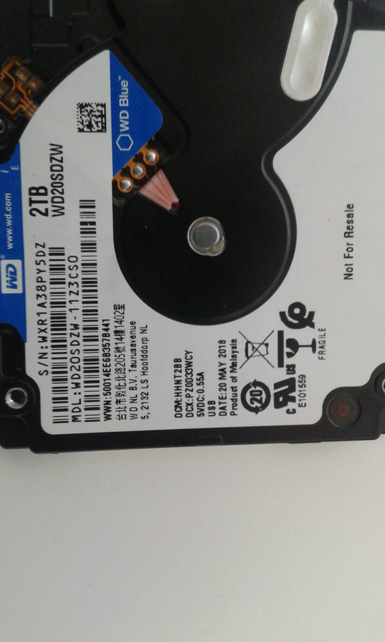

Re: WD10SPZX SED protection
hello ,
i have the drive WD20SDZW WITH SED PROTECTION error; logs giving below;
tb WD USB hdd i convert it to SATa and now it conecte via sata connection . at present it giving following error with Capacity 0ROM:
Read ROM................................ : HDDs ROM reading error Data request error Device Error Detected: "SED DRIVE LOCKED"
Service area:
SA dir reading (ID)..................... : SED DRIVE LOCKED
SA dir reading (ABA/CHS)................ : Dir reading error ABA 0(1) reading error Device Error Detected: "SED DRIVE LOCKED"
Configuration reading................... : Module ID 02 reading error Data request error Device Error Detected: "SED DRIVE LOCKED"
Module ID 0B reading error Data request error Device Error Detected: "SED DRIVE LOCKED"
Block module 02 access
Module ID 00 reading error Data request error Device Error Detected: "SED DRIVE LOCKED"
also drive doesn't detect its family itself
1.Is this drive is support in pc3000 ?
2. if yes, which family should select ?
I attach the pics of the hdd
Whats the pcb no?
betty wrote:Source of the post
This drive is not supported by PC3K
It's Charger family
I can recover it if you'd like to outsource
