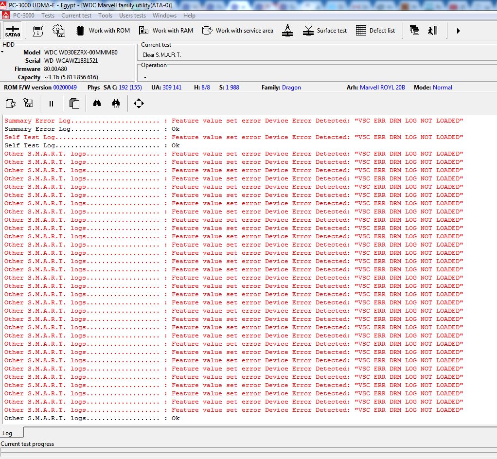

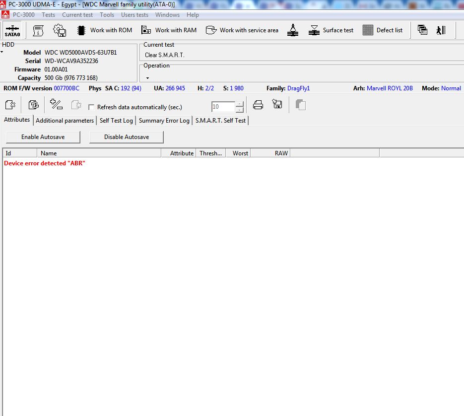

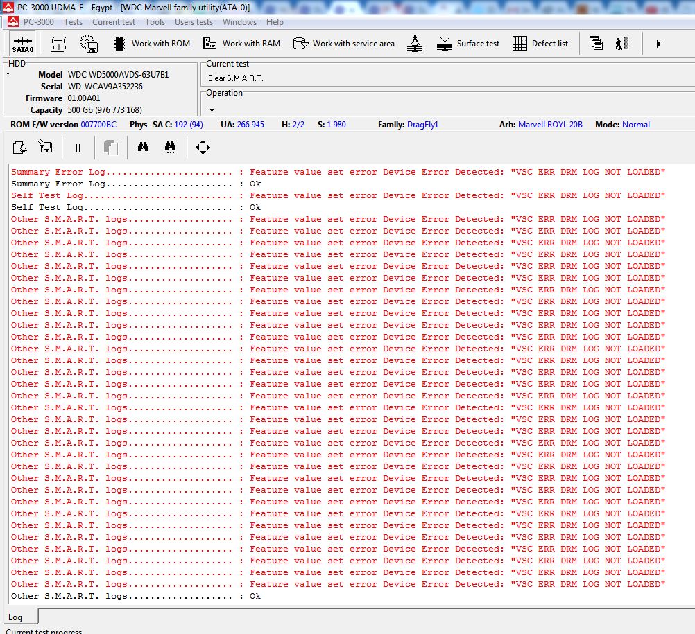

all wd disks make this error when reset smart
i wrote 0021+0022+0023+0024 from alot of disks donor firm
no effects found
can i write any modules else
thanks

Hello there, have you tried the Restore S.M.A.R.T? Be aware that you can only restore it with the same FW version. If you do the result may be positive
